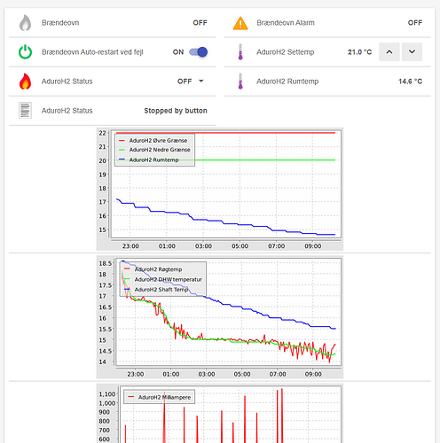

I have been trying out stuff to implement my Hybrid Pellet Oven in OpenHab - to offer me better controls than the manufacturers app.
In order to “give back” to this community, I have collected my setup examples (items, rules etc.) to show how I have done it. You can find these here: GitHub - multimartin/aduroh2-openhab2.5.x: Implemented Aduro H2 Pellet Oven in OpenHab 2.5.x with NBE pellet burner V7/V13 UDP protocol test client

@Andrea_Titoz - I have uploaded the updated files to my GIT.
I have included functionallity to “start wood burn” - but have not had a chance to test it yet.
The GIT mentioned (GitHub - multimartin/aduroh2-openhab2.5.x: Implemented Aduro H2 Pellet Oven in OpenHab 2.5.x with NBE pellet burner V7/V13 UDP protocol test client) has now been updated.
In my case, this now works and served my purpose. Feel free to reuse what you can.
I included a small function/rule with a switch which can be used to “start a fire”, i.e. if you want to turn on firewood with the pellet-function, but have it turn off again as soon as the fire (wood) is burning.
