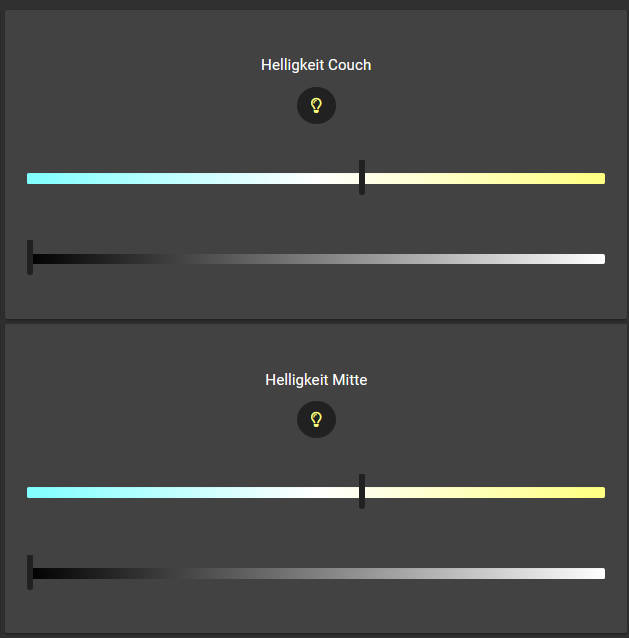

This is what I made for my tunable white lights:
My personal opinion is that warm should be left and cold should be right.
