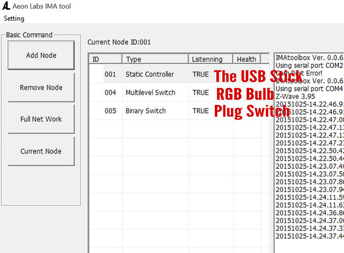

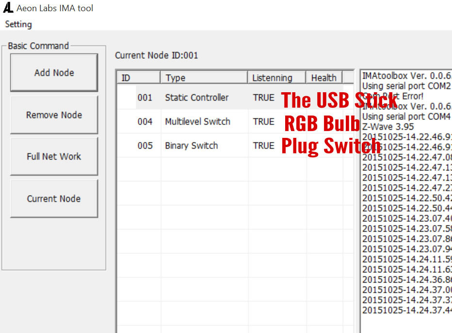

I am pretty sure of the numbers now for the device ID’s as I got this with the IMA tool from Aeon Labs
