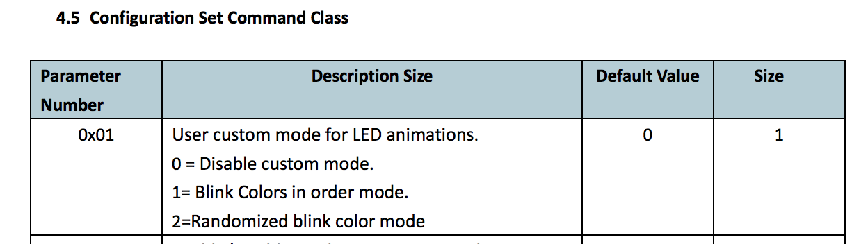

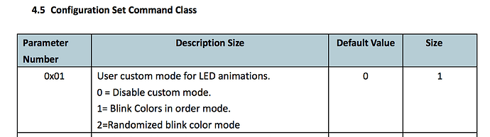

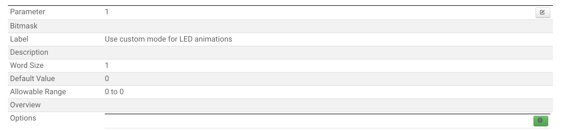

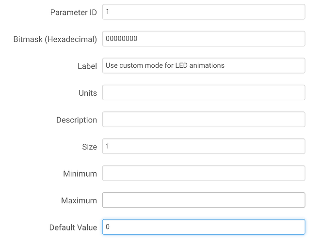

As an example, you need to take the data from the manual -:

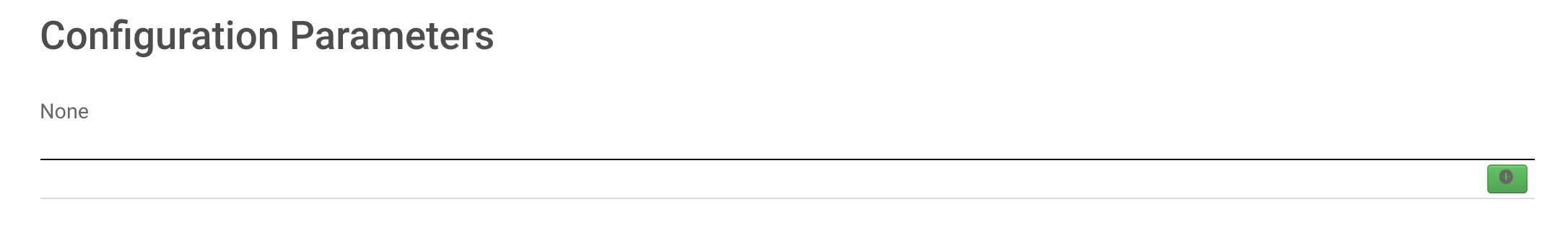

And add it to the database -:

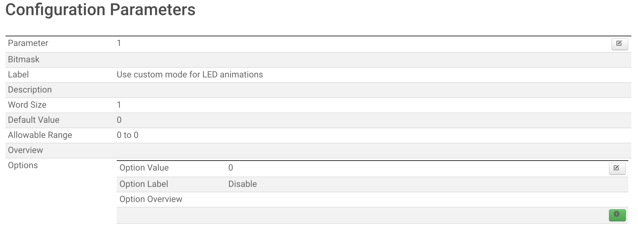

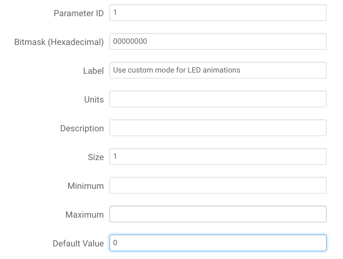

Add a new parameter -:
Click OK

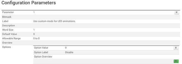

The add the options where there are some (as in this parameter there are 3 -:
And repeat with the other options…

Ok. I have added them all in and added the missing options form the one you added.
  1. Several were ranges and did not have options defined so I did not add options.
  2. Several had 'Units" (MS, K, etc) and I added them in but they do not display on the summary page, only in parameters editor.
  3. I assume all 0x values are hex and translated accordingly. The only reason I mention is is because on page 9 of the tech guide it refers to ‘Parameter 10’, not ‘Parameter x10’. So I may have been wrong on converting them.
Beyond that, hey, it compiles, it’s gotta be right…right? :slight_smile:
Cheers!
=C=
