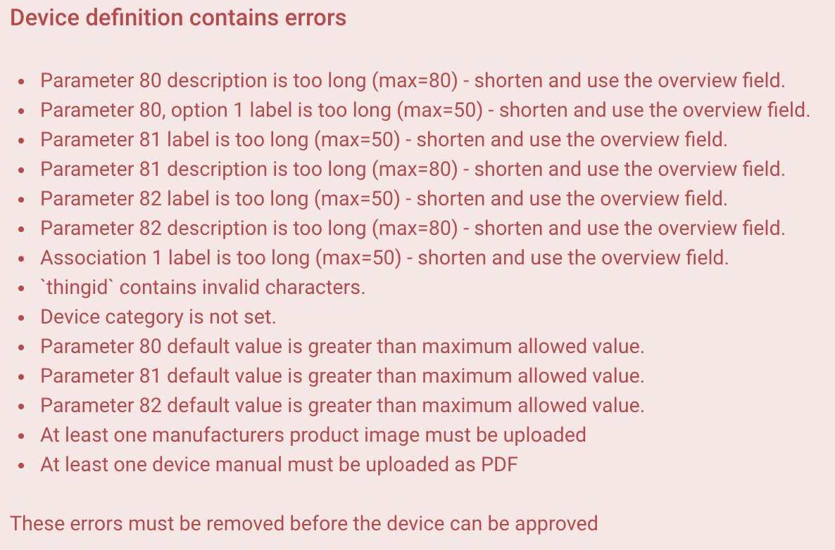

Ok, I’ve created the database entry - as above, it needs a little TLC to tidy it up before I can import it into the binding -:
Please can you take a look at this? Once the errors are removed I’ll get it added to the binding (I will likely do an update later tonight).
Chris
I think I got it all, but I don’t know how to resolve these 2:
- Parameter 81 is limited to options, but there is only 1 option.
- Parameter 82 is limited to options, but there is only 1 option.
I think for both of these you are supposed to be able to enter any number between the min and max.
Correct - I’ve updated the config - there is an option called “allow free entry” and this needed to be checked to allow user input.
