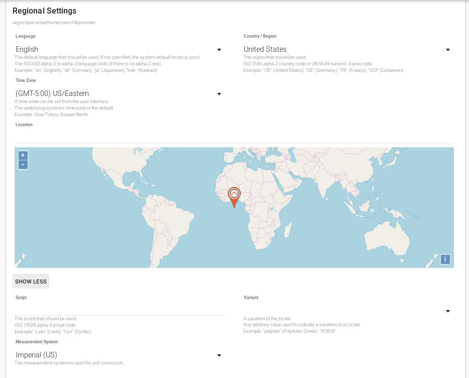

Configuration> System> Regional Settings (show more)…

Well…I had set the region, language, Measurement System, and time zone in PaperUI > Configuration > System
But, after reboot those settings are blank again.
And PaperUI and Android app is showing 19 'C.
Edit: attempting to set these again, notice the save button does nothing…So, it looks like it wasn’t/isn’t set.

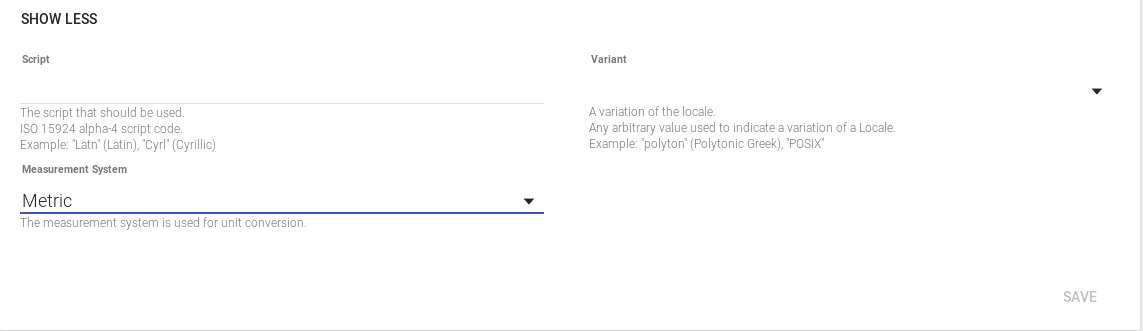

Did you save the settings after changing them? It’s easy to miss, but look at the bottom right of this image…

The Save button highlights when I hover over it, but nothing happens when I click it. (And nothing shows in the log.)
drmacro
(Mac McIlvaine)
October 8, 2018, 3:33pm
18
Actually, after I put in my longitude and latitude it allowed me to save.
