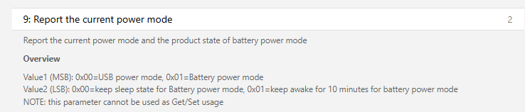

it was added as battery device, then later connected to usb…how can I check what he thinks he is? a battery or mains device?
it doesn’t let me use 86400
I dont understand these hex values, what is 2? what is yours reporting?
Not allowing longer wakeups seems odd. What do you have on the Controller UI for systemwide wakeup. May need to set that to 86400 too.
I don’t have the device, but my read is “2” is battery. I think in binary the options are 00, 10 (2) or 11 (3). The most significant bit (MSB) is on the left in this case.
