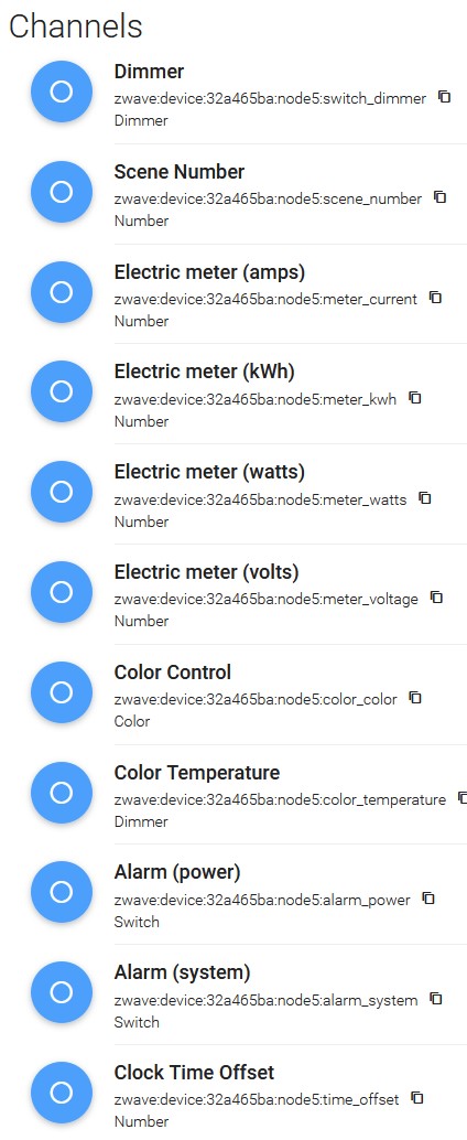

unfortunately the switch does not work for me with openhab
in items config file the important definition looks like this:
Switch LivingRoom_ZW175_Dimmer “Dimmer” (LivingRoom) [“”] {channel = “zwave:device:32a465ba:node5:switch_dimmer”, autoupdate=“false”}
but the only thing i can switch off and on is the led on the switch but not the load ?!
to me it looks like we miss the binary switch
btw: with dimming you can dim the led on the switch, the switch itself has no dimmer built in, its a switch not a dimmer

I would agree- it looks like this needs both switch and dimmer channels. Normally I would have expected these to be implemented inferential endpoints to split the functionality, but it doesn’t seem like that has been done here unfortunately.
My last change to the database was to add the switch_binary channel again and set the switch_dimmer to deprecated.
Is this okay or do we need more edits?
https://www.cd-jackson.com/index.php/zwave/zwave-device-database/zwave-device-list/devicesummary/1134
It seems that both channels are needed as they do different things if I understand the above correctly. It looks like the switch_binary channel does the actual switching of the load, and the switch_dimmer channel just controls the LEDs on the switch?
If so, then both channels would be needed and we should not deprecate the switch_dimmer. It might pay to name the switch_dimmer something like “LED control” or something similar to try and make this clearer?
Done and removed the deprecated flag.

please check the product page from the manufacturer https://aeotec.com/z-wave-plug-in-switch/ and show us the described dimming function
also from the current enabled command classes the only thing i am able to dimm is the LED in the switch but nothing else
from screenshot @Chris_Thomsen posted
Dimmer swich on|off the LED
Color Control no function visible
Brightness dimm the LED
Saturation no function visible
Color Temperature no function visible
Load not switchable
As we know now from above posts: the switch_dimmer channel controls the device LED and the switch_binary channel controls the load, so everything should be good.
