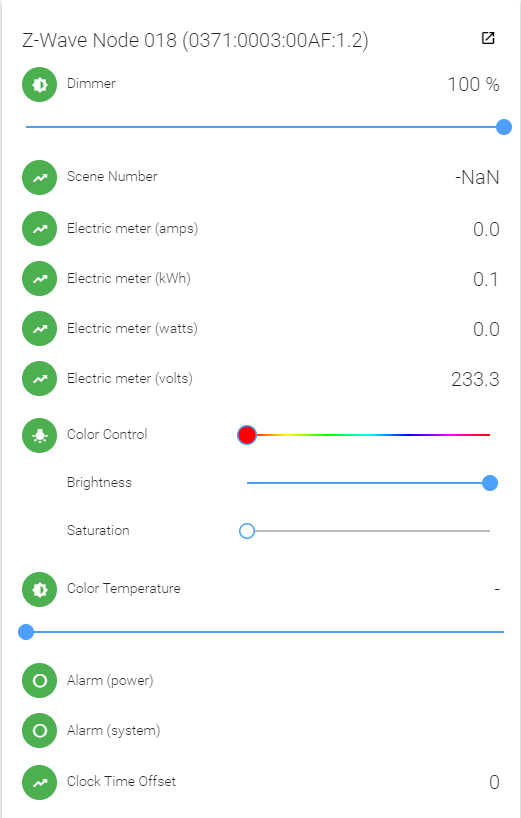

I see that the SS7 has been changed to a dimmer device in the latest build - thats abit odd.. not sure if it even supports dimming?
That channel information usually comes directly from a device through the xml file. I see from aeotec’s site the device appears to support dimming and colour.

@Chris did this change (i created a ticket), as the item couldnt have both dimmer and binary in the device database from what i understand?!
