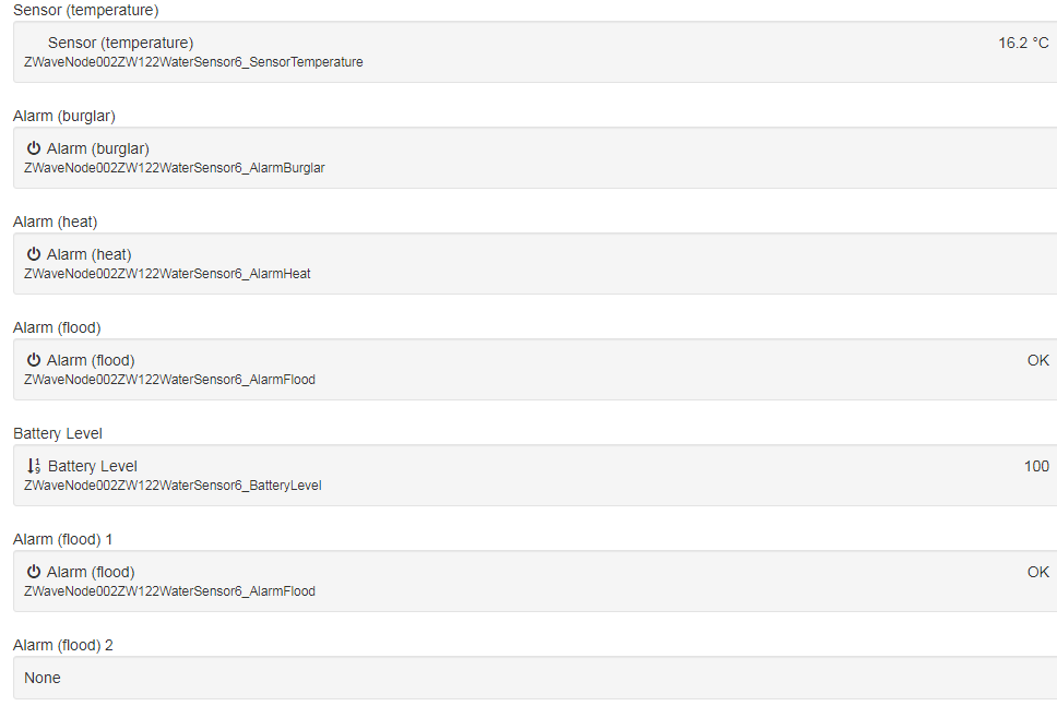

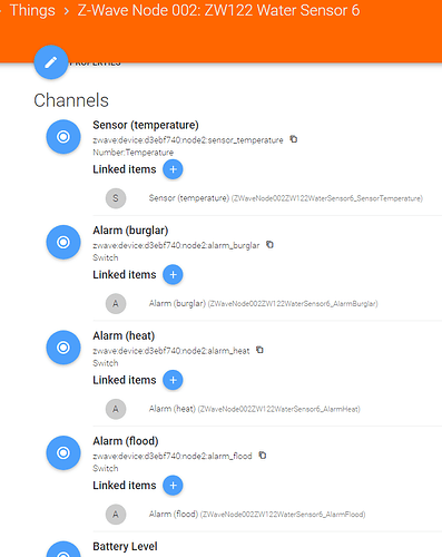

I did discover and add via paperui, but the settings via habmin are easier to list:
It triggers with the alarm_flood:
Just can’t figure out the burglar_alarm..
Anything I could be missing? I did add without security. Do some features not work without that? Even if I pull all the linked channels off, I still see the node reporting the flood alarm:

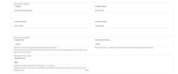

Here is how the lifeline is configured on my device.
Thanks! So interestingly enough I removed it for the 1012th time and messed with it in habmin and now I am getting the alarm type = BURGLAR. No idea what I changed.. But would the association group 1 to controller make the flood alerts be sent but not the burglar? And interesting point that the sensor reports now in F whereas habmin and paperUI still show in C.
NODE 2: Updating channel state zwave:device:d3ebf740:node2:sensor_temperature to 61.4 °F [QuantityType]
It shouldn’t. The lifeline should receive ALL reports that the device sends that are applicable for a gateway controller. Other association groups are typically used to directly control devices.

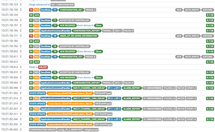

Hey Jay, for your setup does the second or third flood entities ever trigger? For me I have two problems:
  1. The buzzer never goes off.
  2. With the dock, If I put one extension end in the water the first flood entity value changes. If I put the second one in the water it does the exact same thing. Only the first flood value changes. I thought the first was for the first sensor, the second was for the second sensor, and the third floor sensor was for when both were active. Thoughts?
Thanks.

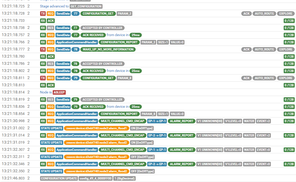

Hey JR,
I haven’t physically tested what you did but here’s my config for all 3 of my units using a USB dock.
