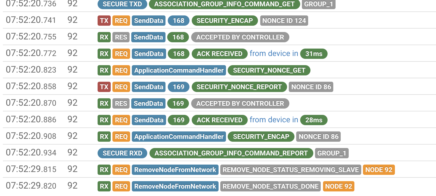

Sorry - I’ve been really busy over hte past week or so. I’ll try and look at it now before I go to bed.
Are you waking up the device enough to actually allow it to complete initialisation? In all 5 of the inclusion attempts, everything looks fine in general, but it never completes initialisation before you reset it and it turns into another node.
You can see below that it’s getting close to sorting out the associations, and you excluded it -:
@chris I removed the device again and added it back again. After adding it, I woke it up 16 times over the course of an hour and half. I would have thought that it should have completed initialisation in that amount of time with that number of individual wake ups. However, it still doesn’t appear to be completing initialisation. I have attached the latest log from my last attempt. Let me know if there is anything I can do or provide to resolve this.
openhab.zip.log (963.2 KB)
openhab.log.7.zip.log (890.9 KB)
openhab.log.6.zip.log (911.7 KB)
Thanks!
I wanted to provide an update that after waiting for about a day and a half, and doing nothing to the controller or the water sensor, it just decided to start sending data to the temperature channel. However, that’s the only channel that seems to be working. The channel for the batter level and the 3 flood alarm sensors don’t seem to be reporting anything. I have tried waking the device up multiple times and nothing seems to get it to report back. Any thoughts on how to resolve that?
@chris any ideas?
@chris or anyone else?
