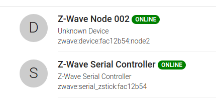

my Aeotec Radiator thermostat ZWA021-C is recognized as unknown device.
As Z-Wave controller I’m using Aeotec ZW090-C.
I think the ZWA021 is similar to Spirit model. Could you please add ZWA021 to the database.
Since it is battery powered, you will need to wait for it to wakeup several times to complete initialization. Or, you can wake it up manually.The Type:ID of your device matches the Spirit, so there is no way to tell them apart, unless there is a difference in firmware.
