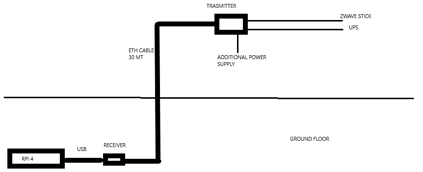

After the install and config has been done, I’ve moved the RPI 4B to it’s final location into the rack cabinet.
Since that time I’m not able to locate the Zwave devices because the bridge went offline.

As far as I can see the device does not show up in the USB ports..
If I plug the device into my Windows PC it gets detected and I have an extra serial port added in the controls..
It seems to be a Rpi4 issue first. Did you restart the Pi with the stick plugged in? Is there any message during the Pi startup that would indicate an issue? Using dmesg.
There was also an issue with some Aeotec5’s on Rpi4 needing a usb2 hub in-between to work properly.
I have restarted the PI without the stick in it and also with the stick plugged in. It was not working in either cases.

Hi all
I have a similar problem.
in my case I installed a powered USB extender via ethernet cable, because the RPI is on the ground floor and instead the zwave stick and the UPS are on the first floor.
I noticed that when I detach the zstick from the hub to add or remove a device, when I go to insert it again, the RPI doesn’t recognize it.
when this happens I go and unplug the USB receiver near the RPI and reconnect it to another USB port, the zwave stick is recognized again
