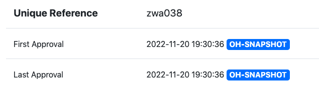

Update: Database entry completed.
The entry seems to be approved in the db. Does this mean one has to wait until this is merged into the OH stable version to become usable?
If you require stable then yes. However, it is in a zwave snapshot binding now. I also believe based on the timing it is in 3.4 milestone 5

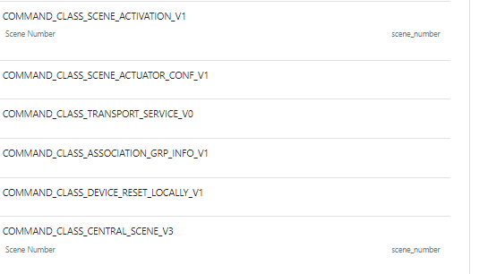

Somewhere that “duplicate channel” is hanging around after removing node5 and clearing the cache. I suspect that a fresh install would have no problems so my situation is an edge case where an unknown z-wave device is added and the artifacts are created within OH internals.
Ok I see it. it is a DB issue, so you will not be able to fix from your end. Something needs to be change between these two endpoints. Maybe delete one? edit: AFAIK only @chris can delete, so maybe change one to something like basic_number?? I’m not sure without the device manual
PS- I was wrong above, it was not your adventures :wink:
I’ve removed the channel linked to the old SCENE_ACTIVATION command class.
Got the switch working as of commit Database update (#1824) · openhab/org.openhab.binding.zwave@d0fd9cd · GitHub
