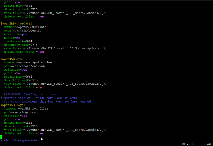

when I tried to share the logs, i tried to edit die smb.conf in the outlined way by ‘uncommand’ the [openHAB-logs] section … into this

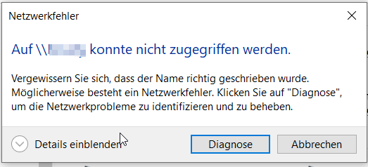

But unfortunately, after that and after a reboot, no file shares worked at all.

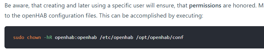

Then I tried to heal it by following these steps:
I did’t change the mask even if the docu shows 0777, because all went fine before.
But when I followed the instructions on the docu, I got an Error on this step:
Something like: ‘/opt/openhab/conf’ - File not found
How can I fix it?
thx guys
/opt/openhab/conf seems to belong to a non apt-package based installation.
For apt based installations I think the related folder can be found at
/var/lib/openhab/conf.

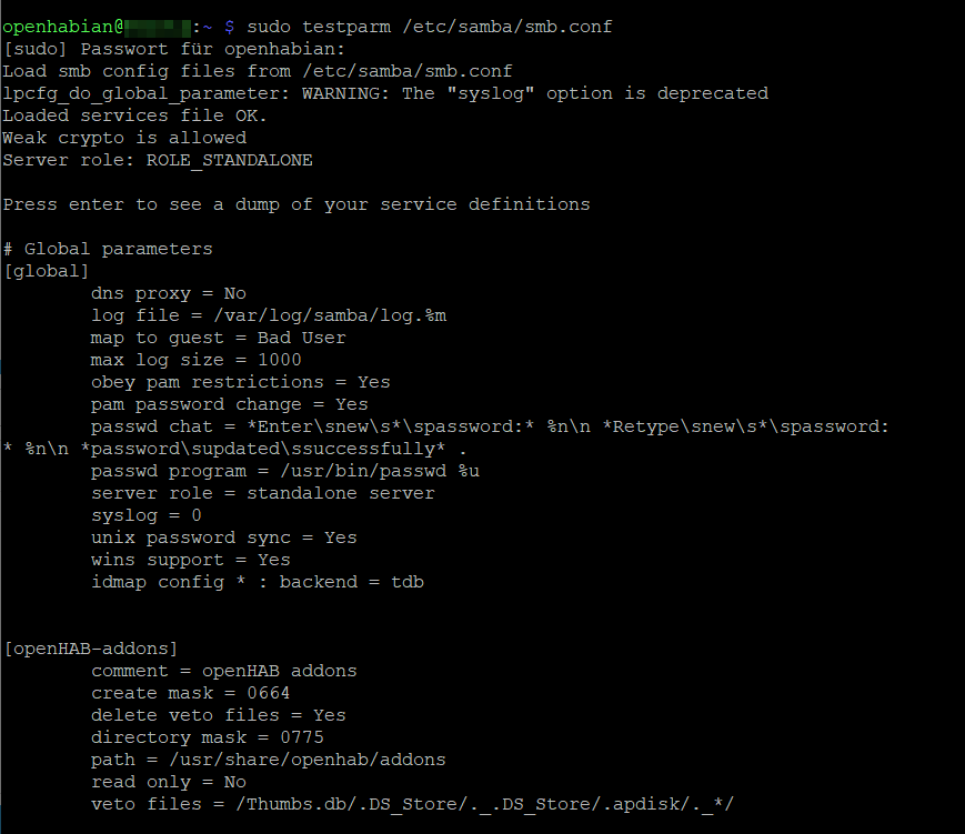

Check if the configuration contains errors:
sudo testparm /etc/samba/smb.conf
Check if you can find error messages in the log files located in /var/log/samba/.
