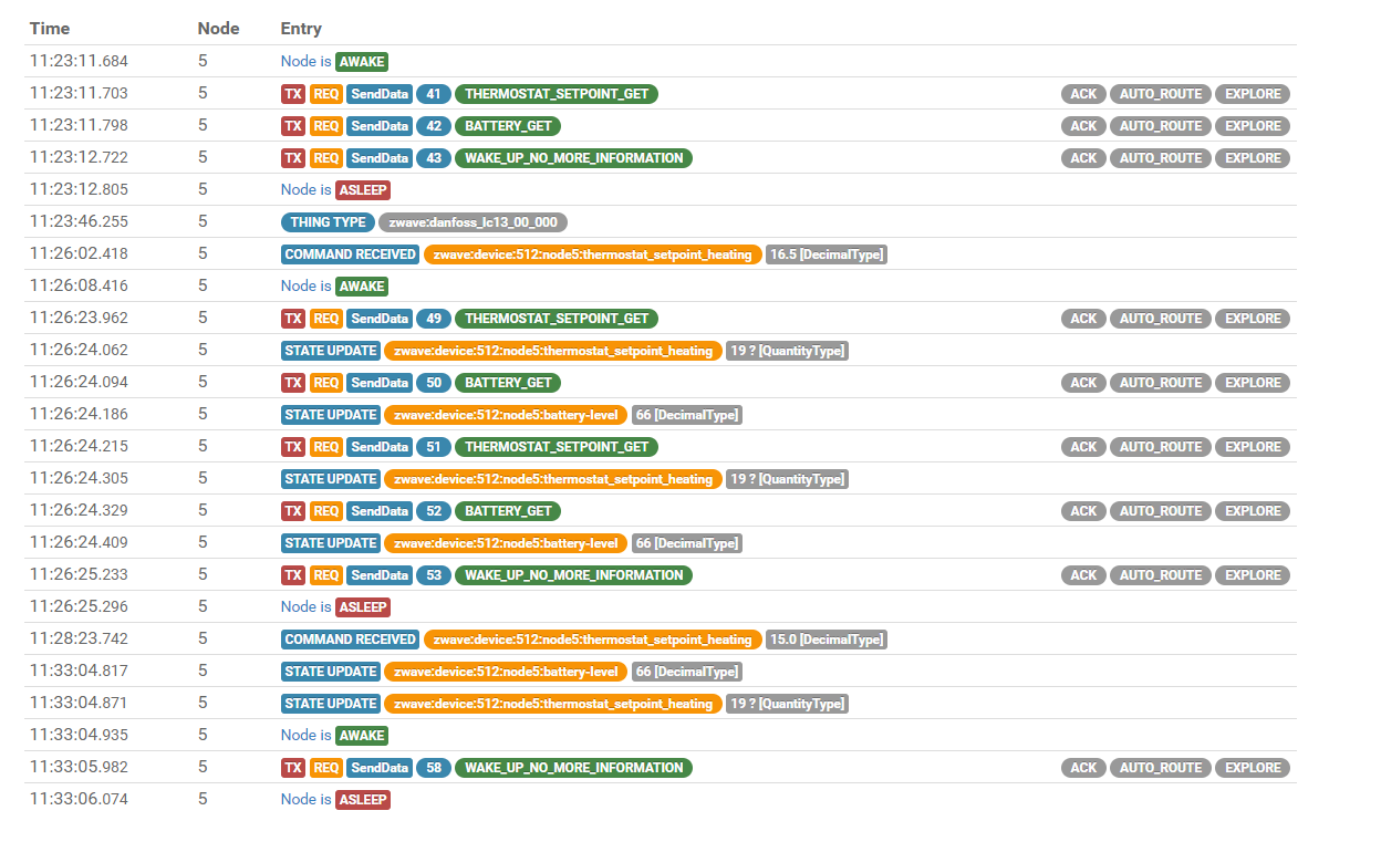

On the thermostat is set 19*C, I use OH to send 15 to the device. In my sitemap I can see the temperature changed to do 15, nothing happens on the thermostat and after a while the sitemap is 19 back again. Nothing changed…
I spent about 20h on this thing… Added, removed, used PaperUI and HABMin… Linking Items, unlinking, removing, adding, removing .xml files… nothing works… I feel dumb and useless… And I have cold home… :frowning:

2018-11-11 11:26:02.414 [ome.event.ItemCommandEvent] - Item 'Termostat_Lazienka_Gora' received command 16.5
2018-11-11 11:26:02.418 [DEBUG] [ding.zwave.handler.ZWaveThingHandler] - NODE 5: Command received zwave:device:512:node5:thermostat_setpoint_heating --> 16.5 [DecimalType]
2018-11-11 11:26:02.435 [vent.ItemStateChangedEvent] - Termostat_Lazienka_Gora changed from 19.0 ? to 16.5 ?
2018-11-11 11:26:02.423 [DEBUG] [ding.zwave.handler.ZWaveThingHandler] - NODE 5: Command for unknown channel zwave:device:512:node5:thermostat_setpoint_heating with DecimalType
2018-11-11 11:26:08.149 [DEBUG] [essage.ApplicationUpdateMessageClass] - NODE 5: Application update request. Node information received. Transaction null
2018-11-11 11:26:08.152 [DEBUG] [ng.zwave.internal.protocol.ZWaveNode] - NODE 5: resetResendCount initComplete=true isDead=false
2018-11-11 11:26:08.154 [DEBUG] [essage.ApplicationUpdateMessageClass] - NODE 5: Application update request. Requesting node state.
2018-11-11 11:26:08.157 [DEBUG] [ding.zwave.handler.ZWaveThingHandler] - NODE 5: Got an event from Z-Wave network: ZWaveDelayedPollEvent
2018-11-11 11:26:08.160 [DEBUG] [ding.zwave.handler.ZWaveThingHandler] - NODE 5: Polling intialised at 86400 seconds - start in 175 milliseconds.
2018-11-11 11:26:08.163 [DEBUG] [essage.ApplicationUpdateMessageClass] - NODE 5: Application update - no transaction.
2018-11-11 11:26:08.335 [DEBUG] [ding.zwave.handler.ZWaveThingHandler] - NODE 5: Polling...
2018-11-11 11:26:08.338 [DEBUG] [ding.zwave.handler.ZWaveThingHandler] - NODE 5: Polling zwave:device:512:node5:thermostat_setpoint_heating
2018-11-11 11:26:08.341 [DEBUG] [ter.ZWaveThermostatSetpointConverter] - NODE 5: Generating poll message for COMMAND_CLASS_THERMOSTAT_SETPOINT, endpoint 0
2018-11-11 11:26:08.344 [DEBUG] [.ZWaveThermostatSetpointCommandClass] - NODE 5: Creating new message for application command THERMOSTAT_SETPOINT_GET (Heating)
2018-11-11 11:26:08.347 [DEBUG] [ng.zwave.internal.protocol.ZWaveNode] - NODE 5: SECURITY not supported
2018-11-11 11:26:08.349 [DEBUG] [ng.zwave.internal.protocol.ZWaveNode] - NODE 5: Command Class COMMAND_CLASS_THERMOSTAT_SETPOINT is NOT required to be secured
2018-11-11 11:26:08.351 [DEBUG] [ding.zwave.handler.ZWaveThingHandler] - NODE 5: Polling zwave:device:512:node5:battery-level
2018-11-11 11:26:08.354 [DEBUG] [rnal.converter.ZWaveBatteryConverter] - NODE 5: Generating poll message for COMMAND_CLASS_BATTERY endpoint 0
2018-11-11 11:26:08.356 [DEBUG] [ng.zwave.internal.protocol.ZWaveNode] - NODE 5: SECURITY not supported
2018-11-11 11:26:08.359 [DEBUG] [ng.zwave.internal.protocol.ZWaveNode] - NODE 5: Command Class COMMAND_CLASS_BATTERY is NOT required to be secured
2018-11-11 11:26:08.361 [DEBUG] [nal.protocol.ZWaveTransactionManager] - NODE 5: Bump transaction 570 priority from Get to Immediate
2018-11-11 11:26:08.364 [DEBUG] [nal.protocol.ZWaveTransactionManager] - NODE 5: Adding to device queue
2018-11-11 11:26:08.366 [DEBUG] [nal.protocol.ZWaveTransactionManager] - NODE 5: Added 570 to queue - size 1
2018-11-11 11:26:08.371 [DEBUG] [nal.protocol.ZWaveTransactionManager] - NODE 5: Bump transaction 571 priority from Get to Immediate
2018-11-11 11:26:08.373 [DEBUG] [nal.protocol.ZWaveTransactionManager] - NODE 5: Adding to device queue
2018-11-11 11:26:08.375 [DEBUG] [nal.protocol.ZWaveTransactionManager] - NODE 5: Added 571 to queue - size 2
2018-11-11 11:26:08.416 [DEBUG] [ng.zwave.internal.protocol.ZWaveNode] - NODE 5: Is awake with 2 messages in the queue
2018-11-11 11:26:08.418 [DEBUG] [ng.zwave.internal.protocol.ZWaveNode] - NODE 5: Start sleep timer at 1000ms
2018-11-11 11:26:08.420 [DEBUG] [ding.zwave.handler.ZWaveThingHandler] - NODE 5: Got an event from Z-Wave network: ZWaveNodeStatusEvent
2018-11-11 11:26:08.435 [DEBUG] [ve.internal.protocol.ZWaveController] - NODE 5: Node Status event - Node is AWAKE
2018-11-11 11:26:08.920 [DEBUG] [ng.zwave.internal.protocol.ZWaveNode] - NODE 5: WakeupTimerTask 2 Messages waiting, state DONE

2018-11-11 11:26:24.127 [DEBUG] [.ZWaveThermostatSetpointCommandClass] - NODE 5: Creating new message for application command THERMOSTAT_SETPOINT_GET (Heating)
2018-11-11 11:26:24.129 [DEBUG] [ng.zwave.internal.protocol.ZWaveNode] - NODE 5: SECURITY not supported
2018-11-11 11:26:24.131 [DEBUG] [ng.zwave.internal.protocol.ZWaveNode] - NODE 5: Command Class COMMAND_CLASS_THERMOSTAT_SETPOINT is NOT required to be secured
2018-11-11 11:26:24.133 [DEBUG] [ding.zwave.handler.ZWaveThingHandler] - NODE 5: Polling zwave:device:512:node5:battery-level
2018-11-11 11:26:24.134 [DEBUG] [rnal.converter.ZWaveBatteryConverter] - NODE 5: Generating poll message for COMMAND_CLASS_BATTERY endpoint 0
2018-11-11 11:26:24.136 [DEBUG] [l.serialmessage.SendDataMessageClass] - NODE 5: sentData successfully placed on stack.
2018-11-11 11:26:24.139 [DEBUG] [ng.zwave.internal.protocol.ZWaveNode] - NODE 5: SECURITY not supported
2018-11-11 11:26:24.140 [DEBUG] [nal.protocol.ZWaveTransactionManager] - NODE 5: TID 571: Transaction not completed
2018-11-11 11:26:24.145 [DEBUG] [ng.zwave.internal.protocol.ZWaveNode] - NODE 5: Command Class COMMAND_CLASS_BATTERY is NOT required to be secured
2018-11-11 11:26:24.150 [DEBUG] [nal.protocol.ZWaveTransactionManager] - NODE 5: Bump transaction 572 priority from Get to Immediate
2018-11-11 11:26:24.158 [DEBUG] [nal.protocol.ZWaveTransactionManager] - NODE 5: Adding to device queue
2018-11-11 11:26:24.160 [DEBUG] [l.serialmessage.SendDataMessageClass] - NODE 5: SendData Request. CallBack ID = 50, Status = Transmission complete and ACK received(0)
2018-11-11 11:26:24.160 [DEBUG] [nal.protocol.ZWaveTransactionManager] - NODE 5: Added 572 to queue - size 1
2018-11-11 11:26:24.162 [DEBUG] [ng.zwave.internal.protocol.ZWaveNode] - NODE 5: resetResendCount initComplete=true isDead=false
2018-11-11 11:26:24.163 [DEBUG] [nal.protocol.ZWaveTransactionManager] - NODE 5: Bump transaction 573 priority from Get to Immediate
2018-11-11 11:26:24.165 [DEBUG] [nal.protocol.ZWaveTransactionManager] - NODE 5: TID 571: Transaction not completed
2018-11-11 11:26:24.165 [DEBUG] [nal.protocol.ZWaveTransactionManager] - NODE 5: Adding to device queue
2018-11-11 11:26:24.170 [DEBUG] [nal.protocol.ZWaveTransactionManager] - NODE 5: Application Command Request (ALIVE:DONE)
2018-11-11 11:26:24.172 [DEBUG] [ng.zwave.internal.protocol.ZWaveNode] - NODE 5: resetResendCount initComplete=true isDead=false
2018-11-11 11:26:24.174 [DEBUG] [ng.zwave.internal.protocol.ZWaveNode] - NODE 5: Incoming command class COMMAND_CLASS_BATTERY, endpoint 0
2018-11-11 11:26:24.176 [DEBUG] [ng.zwave.internal.protocol.ZWaveNode] - NODE 5: SECURITY not supported
2018-11-11 11:26:24.166 [DEBUG] [nal.protocol.ZWaveTransactionManager] - NODE 5: Added 573 to queue - size 2
2018-11-11 11:26:24.179 [DEBUG] [tocol.commandclass.ZWaveCommandClass] - NODE 5: Received COMMAND_CLASS_BATTERY V1 BATTERY_REPORT
2018-11-11 11:26:24.180 [DEBUG] [ommandclass.ZWaveBatteryCommandClass] - NODE 5: Battery report value = 66
2018-11-11 11:26:24.182 [DEBUG] [ding.zwave.handler.ZWaveThingHandler] - NODE 5: Got an event from Z-Wave network: ZWaveCommandClassValueEvent
2018-11-11 11:26:24.184 [DEBUG] [ding.zwave.handler.ZWaveThingHandler] - NODE 5: Got a value event from Z-Wave network, endpoint = 0, command class = COMMAND_CLASS_BATTERY, value = 66
2018-11-11 11:26:24.186 [DEBUG] [ding.zwave.handler.ZWaveThingHandler] - NODE 5: Updating channel state zwave:device:512:node5:battery-level to 66 [DecimalType]
2018-11-11 11:26:24.191 [DEBUG] [nal.protocol.ZWaveTransactionManager] - NODE 5: Commands processed 1.
2018-11-11 11:26:24.193 [DEBUG] [nal.protocol.ZWaveTransactionManager] - NODE 5: Checking command org.openhab.binding.zwave.internal.protocol.ZWaveCommandClassPayload@1c629f.
2018-11-11 11:26:24.195 [DEBUG] [nal.protocol.ZWaveTransactionManager] - NODE 5: Command verified org.openhab.binding.zwave.internal.protocol.ZWaveCommandClassPayload@1c629f.
2018-11-11 11:26:24.197 [DEBUG] [nal.protocol.ZWaveTransactionManager] - NODE 5: notifyTransactionResponse TID:571 DONE
2018-11-11 11:26:24.200 [DEBUG] [ding.zwave.handler.ZWaveThingHandler] - NODE 5: Got an event from Z-Wave network: ZWaveTransactionCompletedEvent
2018-11-11 11:26:24.215 [DEBUG] [ing.zwave.handler.ZWaveSerialHandler] - NODE 5: Sending REQUEST Message = 01 0A 00 13 05 03 43 02 01 25 33 B6
2018-11-11 11:26:24.221 [DEBUG] [ng.zwave.internal.protocol.ZWaveNode] - NODE 5: WakeupTimerTask 2 Messages waiting, state DONE
2018-11-11 11:26:24.252 [DEBUG] [l.serialmessage.SendDataMessageClass] - NODE 5: sentData successfully placed on stack.
2018-11-11 11:26:24.256 [DEBUG] [nal.protocol.ZWaveTransactionManager] - NODE 5: TID 572: Transaction not completed
2018-11-11 11:26:24.274 [DEBUG] [l.serialmessage.SendDataMessageClass] - NODE 5: SendData Request. CallBack ID = 51, Status = Transmission complete and ACK received(0)
2018-11-11 11:26:24.276 [DEBUG] [ng.zwave.internal.protocol.ZWaveNode] - NODE 5: resetResendCount initComplete=true isDead=false
2018-11-11 11:26:24.280 [DEBUG] [nal.protocol.ZWaveTransactionManager] - NODE 5: TID 572: Transaction not completed
2018-11-11 11:26:24.285 [DEBUG] [nal.protocol.ZWaveTransactionManager] - NODE 5: Application Command Request (ALIVE:DONE)
2018-11-11 11:26:24.287 [DEBUG] [ng.zwave.internal.protocol.ZWaveNode] - NODE 5: resetResendCount initComplete=true isDead=false
2018-11-11 11:26:24.289 [DEBUG] [ng.zwave.internal.protocol.ZWaveNode] - NODE 5: Incoming command class COMMAND_CLASS_THERMOSTAT_SETPOINT, endpoint 0
2018-11-11 11:26:24.291 [DEBUG] [ng.zwave.internal.protocol.ZWaveNode] - NODE 5: SECURITY not supported
2018-11-11 11:26:24.293 [DEBUG] [tocol.commandclass.ZWaveCommandClass] - NODE 5: Received COMMAND_CLASS_THERMOSTAT_SETPOINT V1 THERMOSTAT_SETPOINT_REPORT
2018-11-11 11:26:24.295 [DEBUG] [.ZWaveThermostatSetpointCommandClass] - NODE 5: Thermostat Setpoint report Scale = 0
2018-11-11 11:26:24.297 [DEBUG] [.ZWaveThermostatSetpointCommandClass] - NODE 5: Thermostat Setpoint Value = 19
2018-11-11 11:26:24.299 [DEBUG] [.ZWaveThermostatSetpointCommandClass] - NODE 5: Thermostat Setpoint Report, Type Heating (1), value = 19
2018-11-11 11:26:24.301 [DEBUG] [ding.zwave.handler.ZWaveThingHandler] - NODE 5: Got an event from Z-Wave network: ZWaveThermostatSetpointValueEvent
2018-11-11 11:26:24.303 [DEBUG] [ding.zwave.handler.ZWaveThingHandler] - NODE 5: Got a value event from Z-Wave network, endpoint = 0, command class = COMMAND_CLASS_THERMOSTAT_SETPOINT, value = 19
2018-11-11 11:26:24.305 [DEBUG] [ding.zwave.handler.ZWaveThingHandler] - NODE 5: Updating channel state zwave:device:512:node5:thermostat_setpoint_heating to 19 ? [QuantityType]
2018-11-11 11:26:24.310 [DEBUG] [nal.protocol.ZWaveTransactionManager] - NODE 5: Commands processed 1.
2018-11-11 11:26:24.414 [DEBUG] [nal.protocol.ZWaveTransactionManager] - NODE 5: Checking command org.openhab.binding.zwave.internal.protocol.ZWaveCommandClassPayload@1df7852.
2018-11-11 11:26:24.415 [DEBUG] [nal.protocol.ZWaveTransactionManager] - NODE 5: Command verified org.openhab.binding.zwave.internal.protocol.ZWaveCommandClassPayload@1df7852.
2018-11-11 11:26:24.417 [DEBUG] [nal.protocol.ZWaveTransactionManager] - NODE 5: notifyTransactionResponse TID:573 DONE
2018-11-11 11:26:24.421 [DEBUG] [ding.zwave.handler.ZWaveThingHandler] - NODE 5: Got an event from Z-Wave network: ZWaveTransactionCompletedEvent
2018-11-11 11:26:24.713 [DEBUG] [ng.zwave.internal.protocol.ZWaveNode] - NODE 5: WakeupTimerTask 0 Messages waiting, state DONE
2018-11-11 11:26:25.213 [DEBUG] [ng.zwave.internal.protocol.ZWaveNode] - NODE 5: WakeupTimerTask 0 Messages waiting, state DONE
2018-11-11 11:26:25.215 [DEBUG] [ng.zwave.internal.protocol.ZWaveNode] - NODE 5: No more messages, go back to sleep
2018-11-11 11:26:25.217 [DEBUG] [commandclass.ZWaveWakeUpCommandClass] - NODE 5: Creating new message for application command WAKE_UP_NO_MORE_INFORMATION
2018-11-11 11:26:25.218 [DEBUG] [ng.zwave.internal.protocol.ZWaveNode] - NODE 5: SECURITY not supported
2018-11-11 11:26:25.220 [DEBUG] [ng.zwave.internal.protocol.ZWaveNode] - NODE 5: Command Class COMMAND_CLASS_WAKE_UP is NOT required to be secured
2018-11-11 11:26:25.221 [DEBUG] [nal.protocol.ZWaveTransactionManager] - NODE 5: sendTransaction org.openhab.binding.zwave.internal.protocol.transaction.ZWaveCommandClassTransactionPayload@1a3e9a5
2018-11-11 11:26:25.223 [DEBUG] [nal.protocol.ZWaveTransactionManager] - NODE 5: Bump transaction 574 priority from Immediate to Immediate
2018-11-11 11:26:25.225 [DEBUG] [nal.protocol.ZWaveTransactionManager] - NODE 5: Adding to device queue
2018-11-11 11:26:25.227 [DEBUG] [nal.protocol.ZWaveTransactionManager] - NODE 5: Added 574 to queue - size 1
2018-11-11 11:26:25.233 [DEBUG] [ing.zwave.handler.ZWaveSerialHandler] - NODE 5: Sending REQUEST Message = 01 09 00 13 05 02 84 08 25 35 7E
2018-11-11 11:26:25.260 [DEBUG] [l.serialmessage.SendDataMessageClass] - NODE 5: sentData successfully placed on stack.
2018-11-11 11:26:25.263 [DEBUG] [nal.protocol.ZWaveTransactionManager] - NODE 5: TID 574: Transaction not completed
2018-11-11 11:26:25.281 [DEBUG] [l.serialmessage.SendDataMessageClass] - NODE 5: SendData Request. CallBack ID = 53, Status = Transmission complete and ACK received(0)
2018-11-11 11:26:25.283 [DEBUG] [ng.zwave.internal.protocol.ZWaveNode] - NODE 5: resetResendCount initComplete=true isDead=false
2018-11-11 11:26:25.286 [DEBUG] [nal.protocol.ZWaveTransactionManager] - NODE 5: Response processed after 49ms
2018-11-11 11:26:25.287 [DEBUG] [nal.protocol.ZWaveTransactionManager] - NODE 5: TID 574: Transaction completed
2018-11-11 11:26:25.288 [DEBUG] [nal.protocol.ZWaveTransactionManager] - NODE 5: notifyTransactionResponse TID:574 DONE
2018-11-11 11:26:25.290 [DEBUG] [ding.zwave.handler.ZWaveThingHandler] - NODE 5: Got an event from Z-Wave network: ZWaveTransactionCompletedEvent
2018-11-11 11:26:25.296 [DEBUG] [ng.zwave.internal.protocol.ZWaveNode] - NODE 5: Went to sleep COMPLETE
2018-11-11 11:28:23.742 [DEBUG] [ding.zwave.handler.ZWaveThingHandler] - NODE 5: Command received zwave:device:512:node5:thermostat_setpoint_heating --> 15.0 [DecimalType]
2018-11-11 11:28:23.742 [ome.event.ItemCommandEvent] - Item 'Termostat_Lazienka_Gora' received command 15.0
2018-11-11 11:28:23.761 [DEBUG] [ding.zwave.handler.ZWaveThingHandler] - NODE 5: Command for unknown channel zwave:device:512:node5:thermostat_setpoint_heating with DecimalType
2018-11-11 11:28:23.769 [vent.ItemStateChangedEvent] - Termostat_Lazienka_Gora changed from 19 ? to 15.0 ?
2018-11-11 11:31:41.171 [DEBUG] [ding.zwave.handler.ZWaveThingHandler] - NODE 5: Channel zwave:device:512:node5:thermostat_setpoint_heating linked - polling started.
2018-11-11 11:33:04.790 [DEBUG] [nal.protocol.ZWaveTransactionManager] - NODE 5: Application Command Request (ALIVE:DONE)
2018-11-11 11:33:04.793 [DEBUG] [ng.zwave.internal.protocol.ZWaveNode] - NODE 5: resetResendCount initComplete=true isDead=false
2018-11-11 11:33:04.797 [DEBUG] [ng.zwave.internal.protocol.ZWaveNode] - NODE 5: Incoming command class COMMAND_CLASS_BATTERY, endpoint 0
2018-11-11 11:33:04.800 [DEBUG] [ng.zwave.internal.protocol.ZWaveNode] - NODE 5: SECURITY not supported
2018-11-11 11:33:04.803 [DEBUG] [tocol.commandclass.ZWaveCommandClass] - NODE 5: Received COMMAND_CLASS_BATTERY V1 BATTERY_REPORT
2018-11-11 11:33:04.806 [DEBUG] [ommandclass.ZWaveBatteryCommandClass] - NODE 5: Battery report value = 66
2018-11-11 11:33:04.809 [DEBUG] [ding.zwave.handler.ZWaveThingHandler] - NODE 5: Got an event from Z-Wave network: ZWaveCommandClassValueEvent
2018-11-11 11:33:04.813 [DEBUG] [ding.zwave.handler.ZWaveThingHandler] - NODE 5: Got a value event from Z-Wave network, endpoint = 0, command class = COMMAND_CLASS_BATTERY, value = 66
2018-11-11 11:33:04.817 [DEBUG] [ding.zwave.handler.ZWaveThingHandler] - NODE 5: Updating channel state zwave:device:512:node5:battery-level to 66 [DecimalType]
2018-11-11 11:33:04.824 [DEBUG] [nal.protocol.ZWaveTransactionManager] - NODE 5: Commands processed 1.
2018-11-11 11:33:04.828 [DEBUG] [nal.protocol.ZWaveTransactionManager] - NODE 5: Checking command org.openhab.binding.zwave.internal.protocol.ZWaveCommandClassPayload@15b7d76.
2018-11-11 11:33:04.846 [DEBUG] [nal.protocol.ZWaveTransactionManager] - NODE 5: Application Command Request (ALIVE:DONE)
2018-11-11 11:33:04.849 [DEBUG] [ng.zwave.internal.protocol.ZWaveNode] - NODE 5: resetResendCount initComplete=true isDead=false
2018-11-11 11:33:04.852 [DEBUG] [ng.zwave.internal.protocol.ZWaveNode] - NODE 5: Incoming command class COMMAND_CLASS_THERMOSTAT_SETPOINT, endpoint 0
2018-11-11 11:33:04.855 [DEBUG] [ng.zwave.internal.protocol.ZWaveNode] - NODE 5: SECURITY not supported
2018-11-11 11:33:04.857 [DEBUG] [tocol.commandclass.ZWaveCommandClass] - NODE 5: Received COMMAND_CLASS_THERMOSTAT_SETPOINT V1 THERMOSTAT_SETPOINT_REPORT
2018-11-11 11:33:04.859 [DEBUG] [.ZWaveThermostatSetpointCommandClass] - NODE 5: Thermostat Setpoint report Scale = 0
2018-11-11 11:33:04.861 [DEBUG] [.ZWaveThermostatSetpointCommandClass] - NODE 5: Thermostat Setpoint Value = 19
2018-11-11 11:33:04.863 [DEBUG] [.ZWaveThermostatSetpointCommandClass] - NODE 5: Thermostat Setpoint Report, Type Heating (1), value = 19
2018-11-11 11:33:04.865 [DEBUG] [ding.zwave.handler.ZWaveThingHandler] - NODE 5: Got an event from Z-Wave network: ZWaveThermostatSetpointValueEvent
2018-11-11 11:33:04.867 [DEBUG] [ding.zwave.handler.ZWaveThingHandler] - NODE 5: Got a value event from Z-Wave network, endpoint = 0, command class = COMMAND_CLASS_THERMOSTAT_SETPOINT, value = 19
2018-11-11 11:33:04.871 [DEBUG] [ding.zwave.handler.ZWaveThingHandler] - NODE 5: Updating channel state zwave:device:512:node5:thermostat_setpoint_heating to 19 ? [QuantityType]
