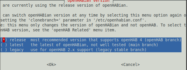

Using menu 45 shows the following error:
My current branch settings
