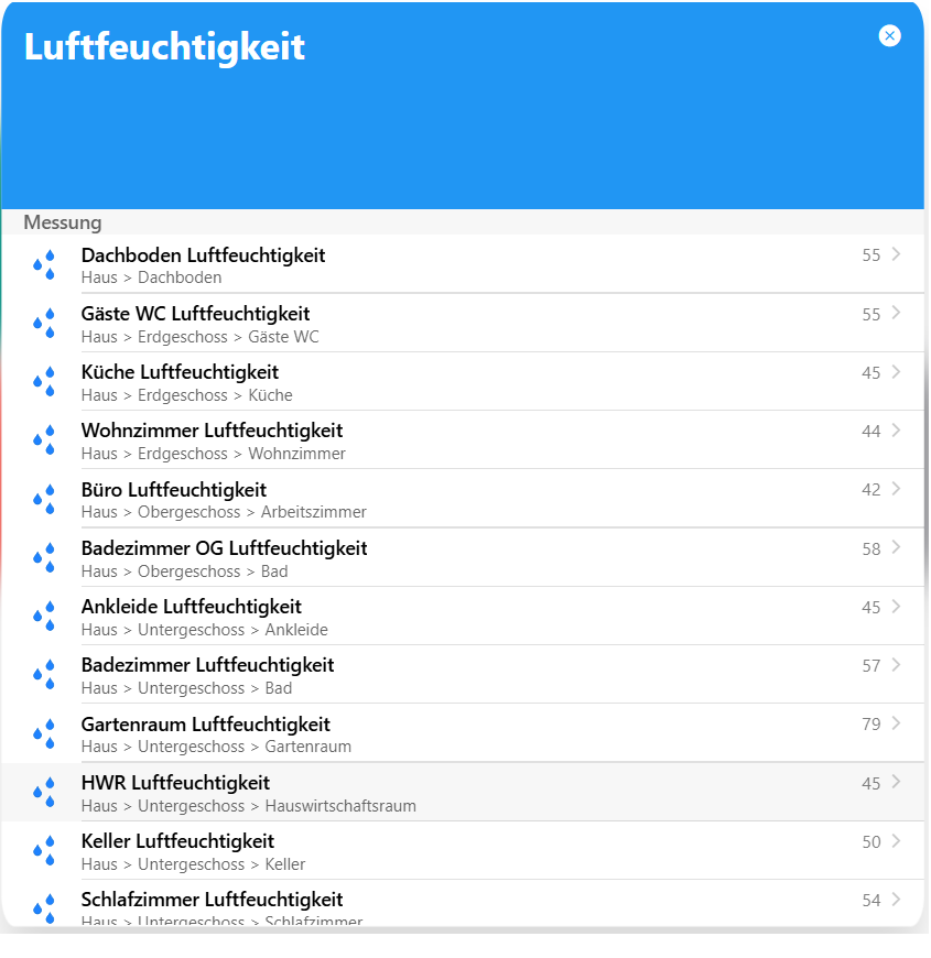

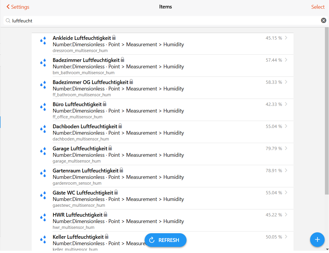

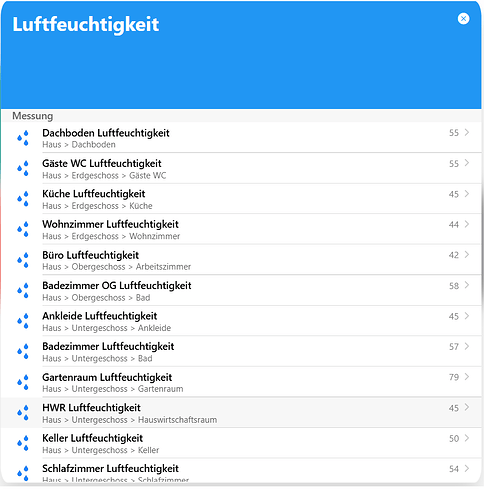

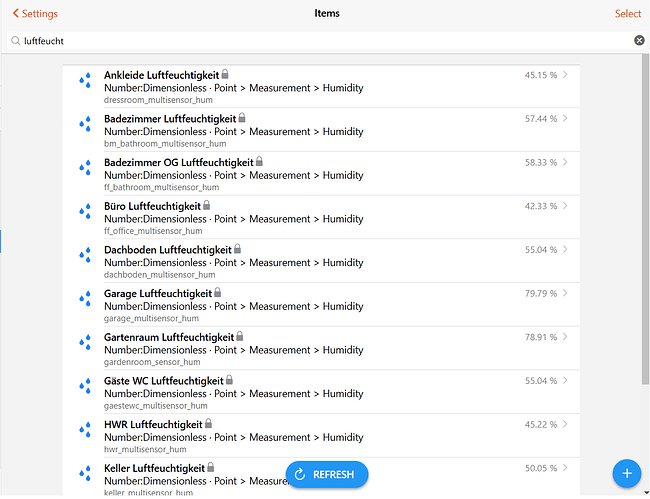

Hi everybody,
I just upgraded my openhab from 4.1 to 4.3 (latest docker image). I seems to work everything :), but in openhab 4.3 the units are not showing anymore in the default cards. Futhermore the values shown as int and not as decimal values.
For example:
In the Settings → Items page the units are shown and the values are shown as decimal value.
What do I have to do so that the items are shown with the correct unit and as decimal value in the cards (e.g default humidity card)?
In most cases I created the things and items from config file.
If you need futher information, let me know.
Thank you very much :slight_smile:
