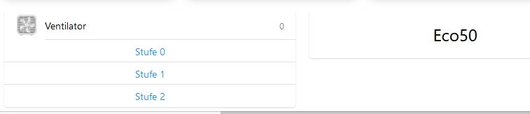

I stuck with creating a proper entry to Main UI Pages to change Air Ventilation :-/
With some help from Udo I was able to get an entry in page overview, but with permanent options
I do have a washingdisher where binding seems to provide a pop up of available options
I imagine if there is a way to create an entry like this for a ventilation items, which provides listed options??

I created a new object, but it doesn’t work :-/
> component: oh-label-card
> config:
>   action: options
>   actionModal: page:Ventilation
>   icon: oh:fan
>   item: Ventilator2
>   actionOptions: 0=OFF,1=Stufe 1,2=Stufe 2
> slots: null

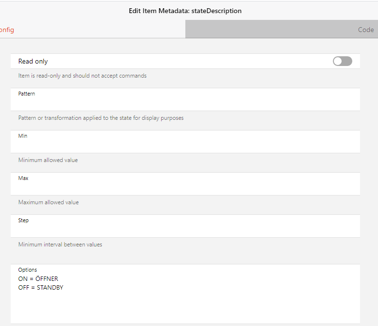

my 2 cents here, for me this works as well, i have made the action commands in the widget corresponding with the state description pattern “options” in the item. Not sure if this is the trick but probably worth a try?
