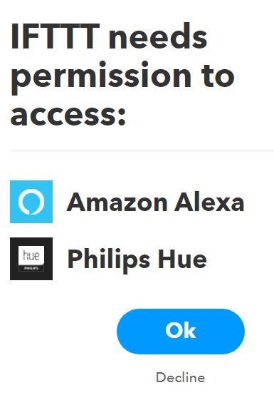

I have not tested that yet, but when I go to the setup of that IFTTT sketch I get:
so I assume this would only work with HUE lights. But I’m not sure …
