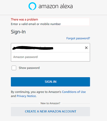

I know the credentials I am providing are correct as I can log-in to my amazon account successfully and the Alexa App. However what is new is that any new sign in attempts to my Amazon account results in a text message and I then have to approve/deny the logon attempt.
I am wondering if this new behaviour is having an impact on my sign in / authentication attempts via OpenHAB.
