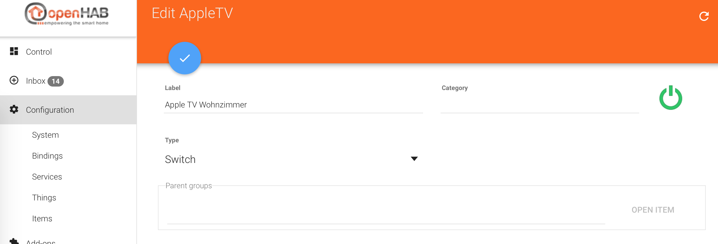

I created an item to the Harmony Device “Apple TV” in my config:
Switch AppleTV “Apple TV Wohnzimmer” [ “Switchable” ] {channel="harmonyhub:device:Media:44202781:buttonPress}

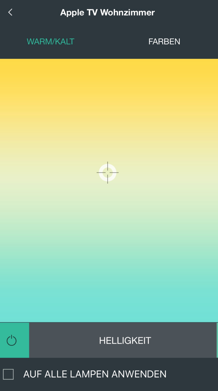

The Harmony discovers the “Apple TV” as a light, and wants to handle it like a that. (In Harmony App Color Changing). Even if I press the ON button in the harmony app nothing happens…
I’ve read the harmony Tutorial but I am lost. Perhaps I did something wrong at the beginning as I linked the things / Items with Paper UI?
Thats how it looks like…

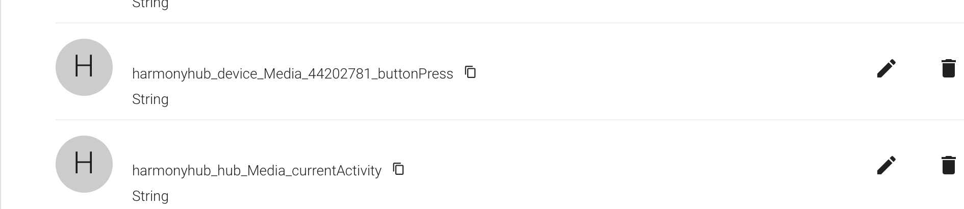

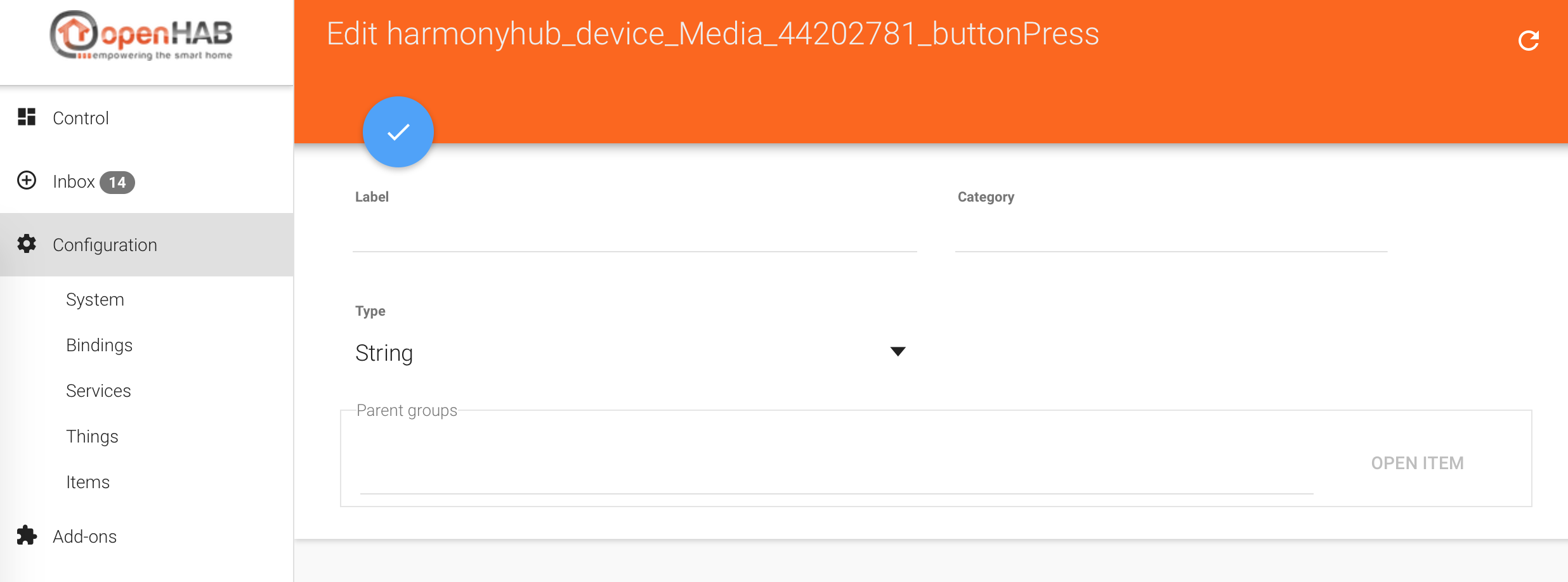

The item:
…and there is another item?!:
@sinthom I’m not familiar with Alexa, but with Harmony Hub.
But your “Apple TV” should NOT be a LIGHT.
