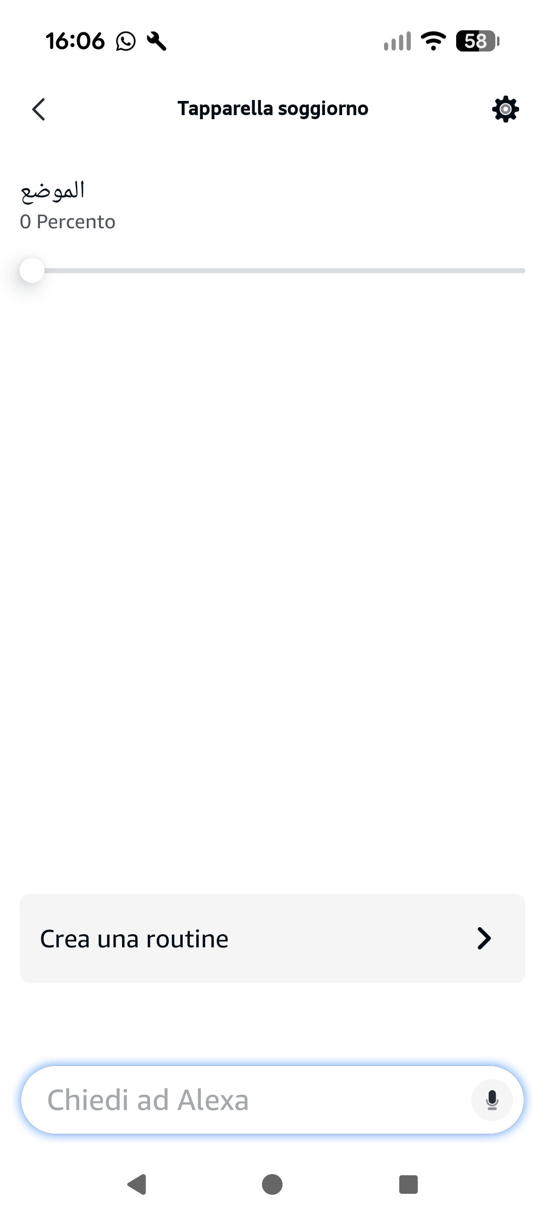

In the Alexa mobile app, the position control page of every rollershutter now displays the Arabic word:
الموضع
above the percentage slider. This means “Position”, but my Alexa app is configured in Italian, my Echo devices are configured in Italian, and the openHAB regional settings are Italian / Italy / Europe-Rome.
The rest of the Alexa UI on the same page is correctly displayed in Italian (for example, “Percento”).
Alexa also reports these devices as “Connected via openHAB”.

The only small anomaly that still remains is in the Alexa mobile app: for all my roller shutters, the label displayed above the percentage is still shown in Arabic (الموضع) instead of Italian.
Apart from that, voice control seems to be working normally again.
