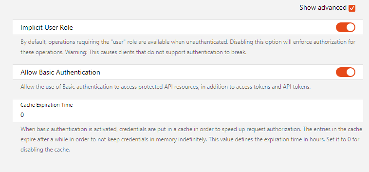

Did you by any change disable the API Security Implicit User Role? If so, the skill will not work if this setting is not enable.
I believe these are all set correctly for Alexa to work.
These looks good.
