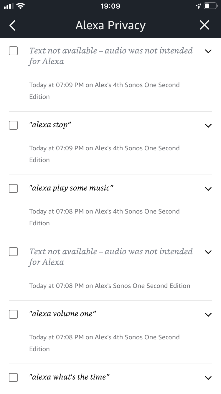

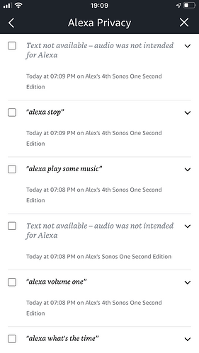

More findings on this. I went to “review voice history” in the privacy settings on the Alexa app, and it looks like Alexa is now programmed to ignore commands which are intended for other devices. See this screenshot:
In this example, my alexa centric commands are converted to text and therefore available under lastVoiceCommand, but where the command includes mention of a smarthome device (i.e. ‘lights on’ or ‘blinds up’), the voice history only states ‘Audio was not intended for this device’ (again, it doesn’t matter if the device even exists in the system). Interestingly, the audio itself is still there, and I can access all commands as normal by pressing the chevron.
It looks like Alexa redacts/stops processing any command which is deemed to not be directed specifically at Alexa.
I’m assuming this is all done server-side, so it seems unlikely that it can be resolved through the binding. Kinda breaks the endless possibilities of lastVoiceCommand :frowning:
