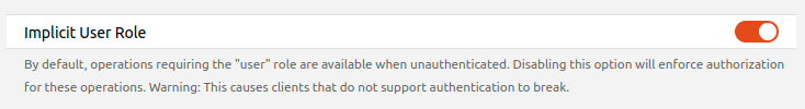

I wanted that the REST API can only be used with token so I disabled this option
but I reverted that and now the alexa app finds all my devices again but the message remains. (How to make REST calls authorized and still use alexa is another topic I guess)

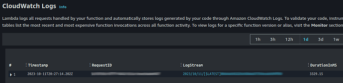

What do your Lambda skill function logs show?

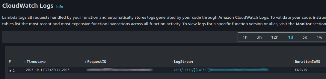

Hi @jeshab
thanks for the reply. I’m not really sure if I’m at the right place since the log only shows the deployment
At least I think it has to be the deployment.
Best regards

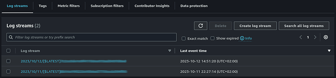

What do you see inside the skill log stream? Any errors?

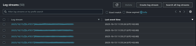

log streams looks like this

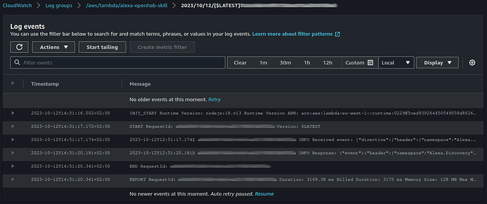

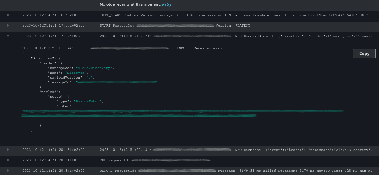

Last event looks like this
Which was the discovery
Looks like no request gets to the lambda function but I have no idea why.

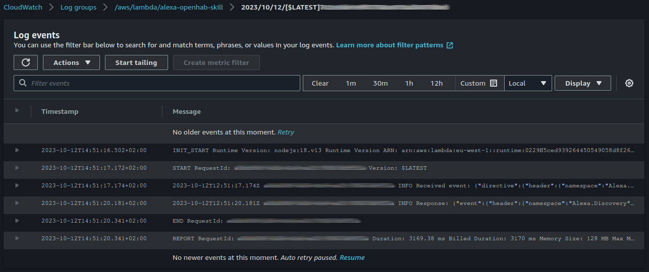

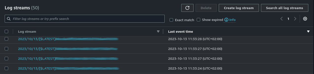

Log has changed and has a lot more entries
Now there is not only discovery but also reportState
and no errors whats so ever, telling me that the skill is working just fine.
(Let me know if my conclusion is wrong :sweat_smile:)
