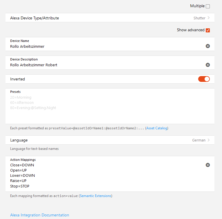

I’d also need some help with getting at least basic room awareness for shutters.
I also have Bticino/OpenWebNet shutters and added them to Alexa using the following configuration:
In Alexa, I added them to the groups representing their rooms.
I can address them using their specific device name (e.g. “Rollo Arbeitszimmer”) but I cannot find any generic command that allows me to say the shutters for a specific room should be lowered.
What are the commands that should work, and what do I maybe need to change in my setup to get there?
Played around a bit now. At least it seems that I can control multiple shutters using their group name, just by saying “Alexa, close [group name]” or “Alexa, open [group name]”. However room awareness does not work, I cannot find any command that opens or closes the shutters in the room the Alexa device is in, without saying the room name.
One question about the friendlyNames: if I define the metadata on the UI, is there even a way to set friendly names? I cannot find any field for it (see the screenshot in my previous post).
Currently, Alexa room awareness is only supported by a handful of categories (e.g. lights and TV) and unfortunately, shutters aren’t part of it. So you have to specify the device name or group name as you have highlighted.

So, what works for me is “Alexa, close [room name]” or “Alexa, open [room name]”. However this is a bit counter-intuitive for me, I’d like it to work with a keyword like “Alexa, close the shutters in [room name]”. I do not fully understand the concept of friendlyNames yet, so I wanted to play around with it to understand it better.
Does the device name on the Alexa side you are trying to control include the term “shutters”? A command request including prepositions doesn’t always work especially for non-english languages. It is usually recommended to use the device name as defined (e.g. open office shutters opposed to open the shutters in the office).
As an alternative, you can also add specific Alexa routines with how you want to request your voice commands.
That’s an old concept that was deprecated at the end of 2021. A new attribute was added to control the position state of a window blind. This is also why you don’t necessarily need to configure the actionMappings parameter unless the default values don’t work for your use case.
Understand. I was looking more for a generic term for shutters that addresses all the shutters in a room, independent of device names. close [room] works fine, but linguistically I’d find it more intuitive to say close the shutters in [room].
