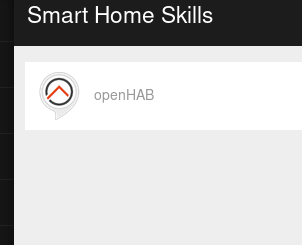

I only have the openHAB skill. I disabled it, deleted all devices, rediscovered and nothing was discovered. Reenabled the OH skill, rediscovered, and these Items came up. No Hue skill. The hueemulation binding is also not installed (confirmed).
