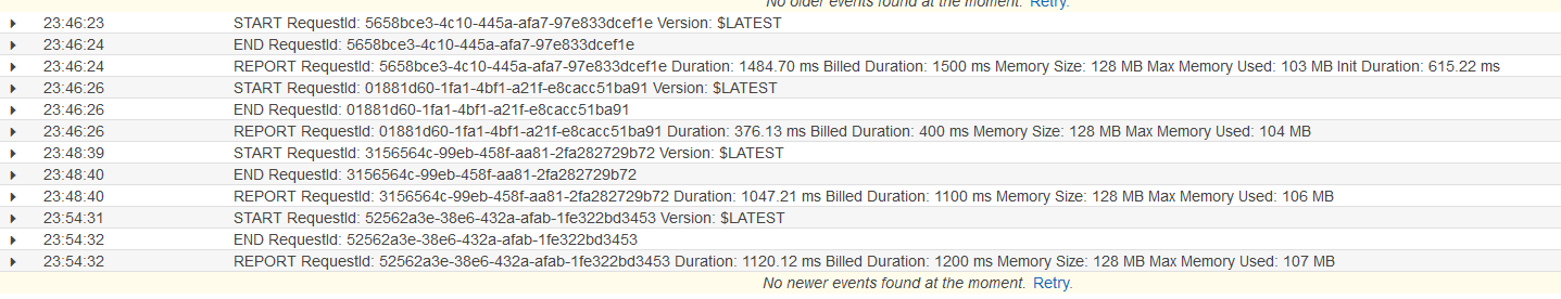

Thanks for that log info, ive added that as an environmental value and I see this now, authorisation failure

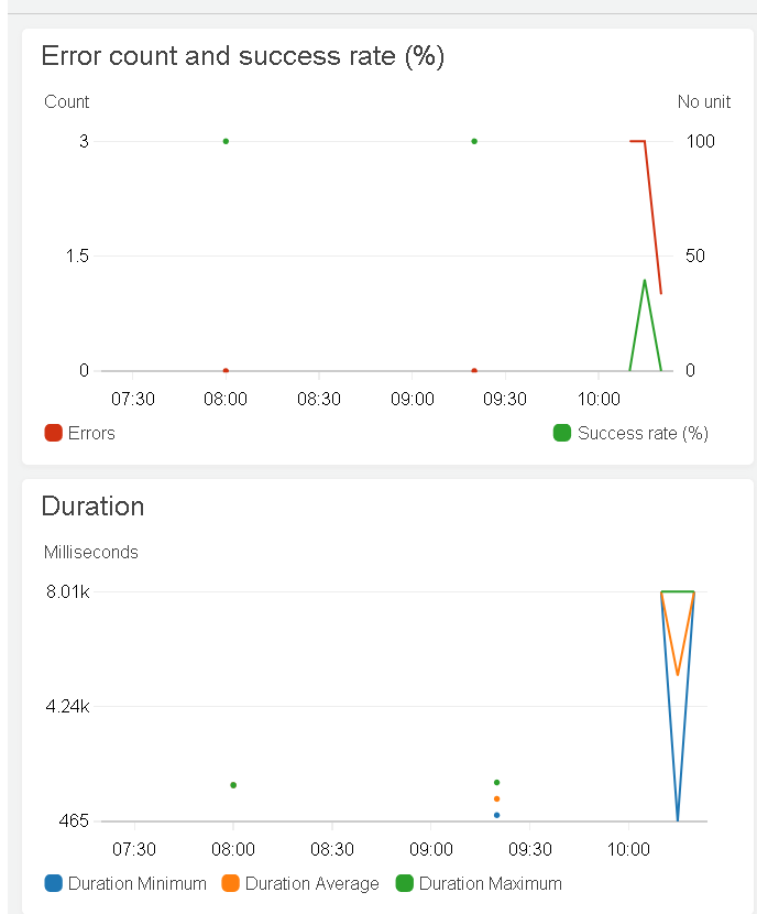

it seems there is some kind of time out issue, never happened on the old skill
I use a private cloud connector, openhab cloud set to notifications & remote, discovery works fine and my nginx is proxy_buffering off
Any thoughts?
thanks
Hard to say with the amount of information you provided. There is a lot of different reasons why this would happen especially if you have the cloud connector in front. You would need to do additional troubleshooting on your end. Use a specific request that failed/timed out and follow it end to end checking logs to see if you can determine the reason.

Still getting timeouts with the required NGINX settings and the new skill. Ill try and dig into it deeper.
Have you tried to increase your Lambda function log level, as per my instructions, and look if any possible log lines that could explain your issue? Usually, a device not responding error indicates that the updated state wasn’t available when the command was issued. This can happen either if the item you send the command doesn’t report a state or it hasn’t been initialized yet. On rare occasion, it could happen on low powered server (e.g. RasPi) where a command received may take longer to update the associated item state. If this is the case, you can try to disable any of the bindings that you aren’t using to free up resources for your OH server to function optimally.
You mentioned about the Lambda function errors you are getting but you didn’t mention the responses you are getting on the relevant Alexa requests. Depending on the Alexa error message you get back, it could be a network/socket error or just an item state error on the OH side. Make sure to go over the troubleshooting guide as well.
