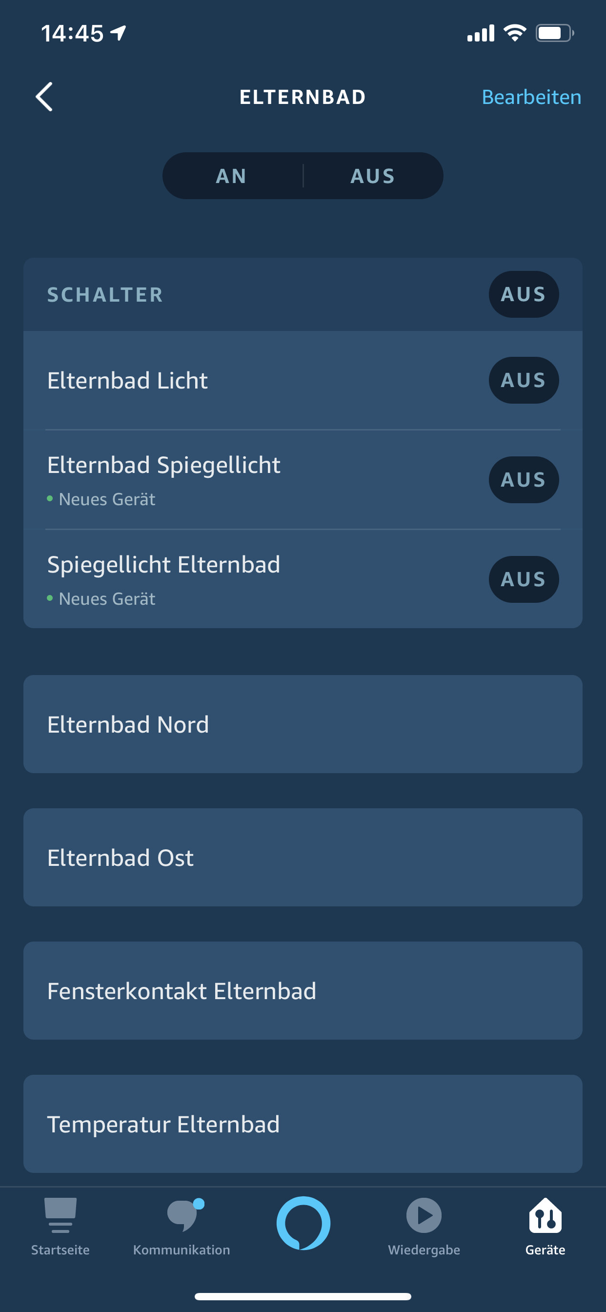

Hi, i have a question regarding the alexa ios app: is it possible to show rollershutters inside a group as rollershutter? Like the light switches for example?
item config:
Rollershutter Elternbad_Nord “Elternbad Nord [%d %%]” { channel=“knx:device:652ac361:Rollladen_D6:Elternbad_Nord”, alexa=“RangeController.rangeValue” [category=“EXTERIOR_BLIND”, friendlyNames=“@Setting.Opening”, supportedRange=“0:100:10”, unitOfMeasure=“Percent”, actionMappings=“Close=100,Open=0,Lower=(+10),Raise=(-10)”, stateMappings=“Closed=100,Open=0”]}
Rollershutter Elternbad_Ost “Elternbad Ost [%d %%]” { channel=“knx:device:652ac361:Rollladen_D6:Elternbad_Ost”, alexa=“RangeController.rangeValue” [category=“EXTERIOR_BLIND”, friendlyNames=“@Setting.Opening”, supportedRange=“0:100:10”, unitOfMeasure=“Percent”, actionMappings=“Close=100,Open=0,Lower=(+10),Raise=(-10)”, stateMappings=“Closed=100,Open=0”]}
This is unfortunately not supported on the Alexa as of yet. It seems that only light and switch items are listed under a named group. Any other items would just be listed individually. I use the Android app and I am seeing the same behavior.
Ok thank you. I thought it could be handled by the property “category”.
