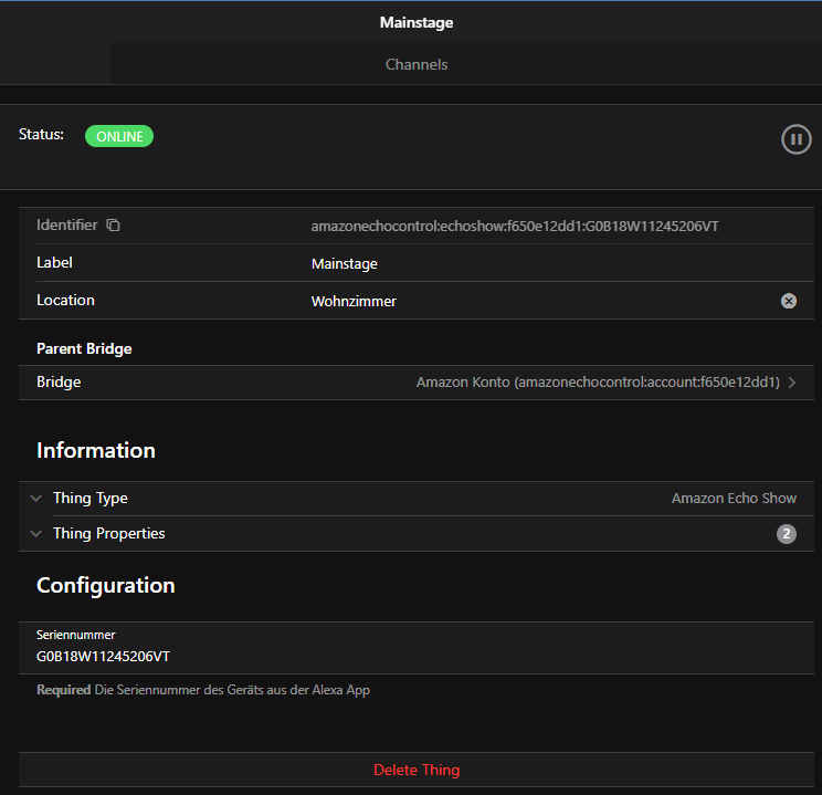

I am still very new to OH and am struggling with the basics - I can’t get my Alexa(s) to speak.

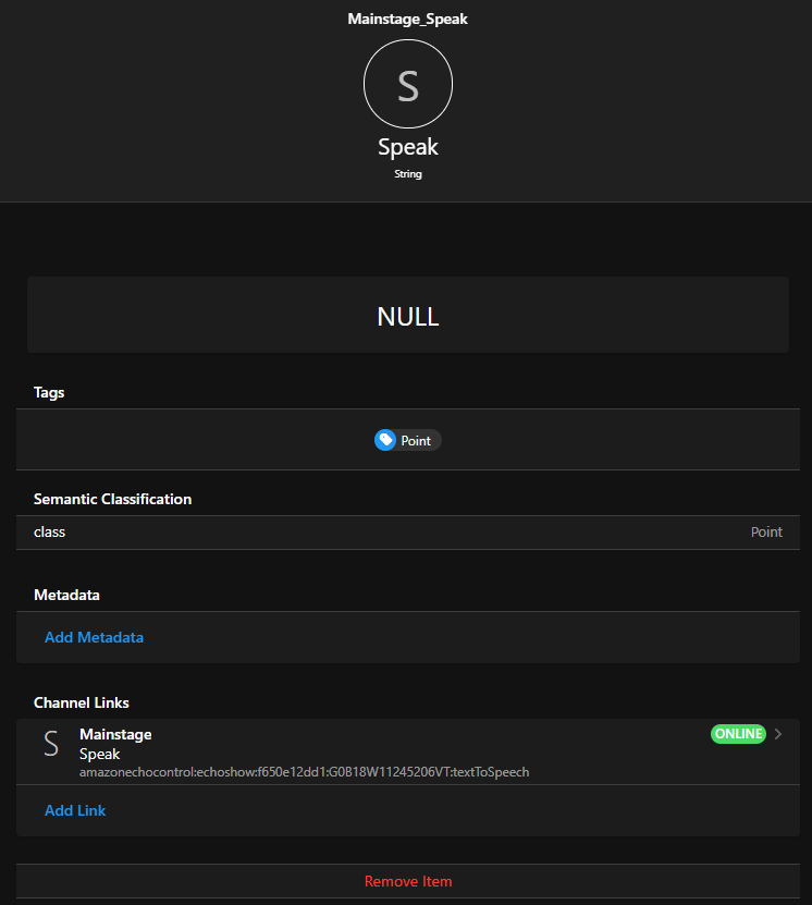

I have already set everything up and connected Amazon. I have also created a channel/item through the corresponding Amazon Thing: (The name of the Alexa is “Mainstage”)
I now want to create a rule that makes Alexa notify me when a window is opened. The rule works because I send a broadcast message that arrives every time. But Alexa remains silent…

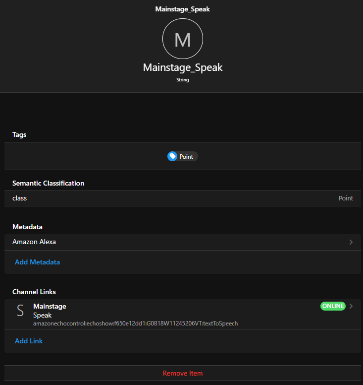

  • What is the Metadata you have on your string item above? I have no metadata on my channels TO the Alexa, and they all work fine (However I have MetaData on the inbound commands from Alexa though). Perhaps try and remove this temporarily

Given you are actually seeing the command being sent in the event log, to the item you have created, at a guess, I don’t think its your rule which is a problem, but more likely something between the Item->Channel->Thing->Binding etc…

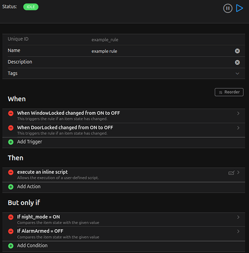

However, if you still want to check rules (and you are willing to tinker in JS script) feel free to grab the following code for a Rule I know works, and modify it as follows:
  • Create the Rule (and give it a name and description)
  • Click on the code tab, and paste the following code in there
  • Replace the item name for the speak channel, with your own item name
  • Save the rule
Then the rest of the configuration can be done via the UI. Remove the example items I have in there, and add your own windows. Anything that triggers the rule, will be announced by Alexa, including the Item label name.
And then you can keep on adding items to the trigger list, without ever changing the underlying code. My actual rule has around 10 items as triggers, and works well.
Note I have a constraint to only announce when the House alarm is unset, and ‘night mode’ item is enabled. Feel free to delete those, for your testing - Just there as an example.

This rule will only work when triggered by an item, so just go and open your window and see what happens !!

  1. The settings of the Alexa Thing:

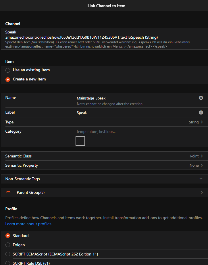

  1. I go to my Alexa Thing, select the TTS Channel, and create a link and a new item

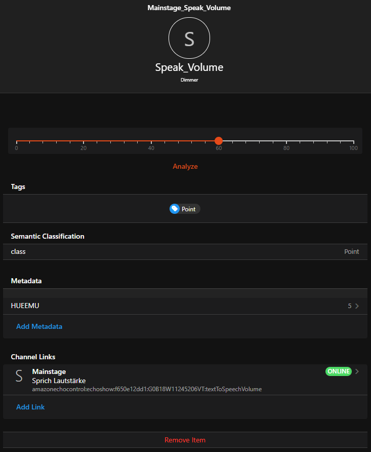

  1. I also create a volume item through the channels and set a volume level:

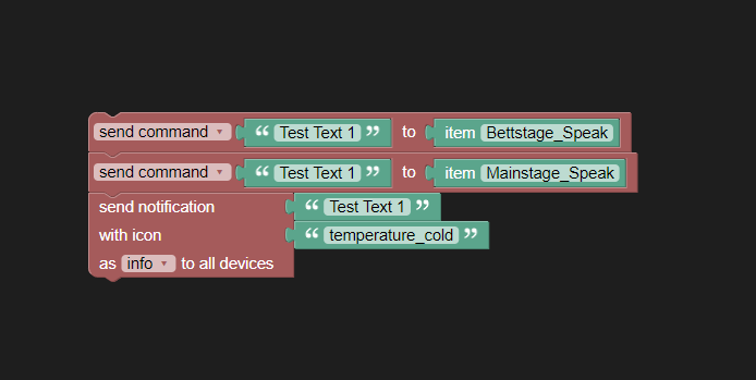

  1. I perform a simple test using Blockly to see if Alexa says something:
I also haven’t quite understood which script type I should use (DSL or EMS-js) and what exactly needs to go into the script. When I trigger a script in a rule, theoretically one line should be enough, like (DSL):
Mainstage_Speak.sendCommand("Test Text");
