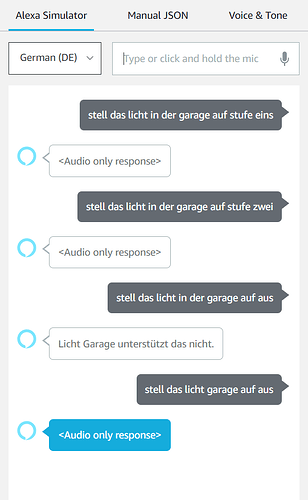

I’m using ModeController.mode for choosing the lights in my garage. Switching between 1 and 2 works perfectly. But sending an OFF command seems not to be working. Alexa says “…does not support the command”.
My item definition looks as follows: Number SWI10_Scene "Licht Garage" <light_bulb> {alexa="ModeController.mode" [supportedModes="0=Aus,1=Stufe 1,2=Stufe 2"]}
Some sample phrases in german:
“Alexa, stell das Licht in der Garage auf Stufe 1” → state switches to 1
“Alexa, stell das Licht in der Garage auf Stufe 2” → state switches to 2
“Alexa, stell das Licht in der Garage auf Aus” → alexa says, “Licht Garage unterstützt das nicht”
Per the issue below, you have to request ON/OFF commands slightly differently. This is probably a limitation on the Alexa side due to the overlapping with the PowerController/ToggleController interfaces.

The post by @jeshab is your answer. The correct commands are sent to OH
I don’t understand german but Alexa is limited as he said and you may have to put up with it until it gets clever enough or the amazon devs resolve the issue:
You can certainly create a group endpoint for that device using a proxy Switch item, modeled as PowerController, that would update the Number item on ON/OFF requests. This will resolve your issue although you would have to support ON requests as well.

There are no other solutions here. As @vzorglub mentioned, we can’t go around the Alexa limitations. You can always post on the Amazon developer forum with your feedback and concerns.
