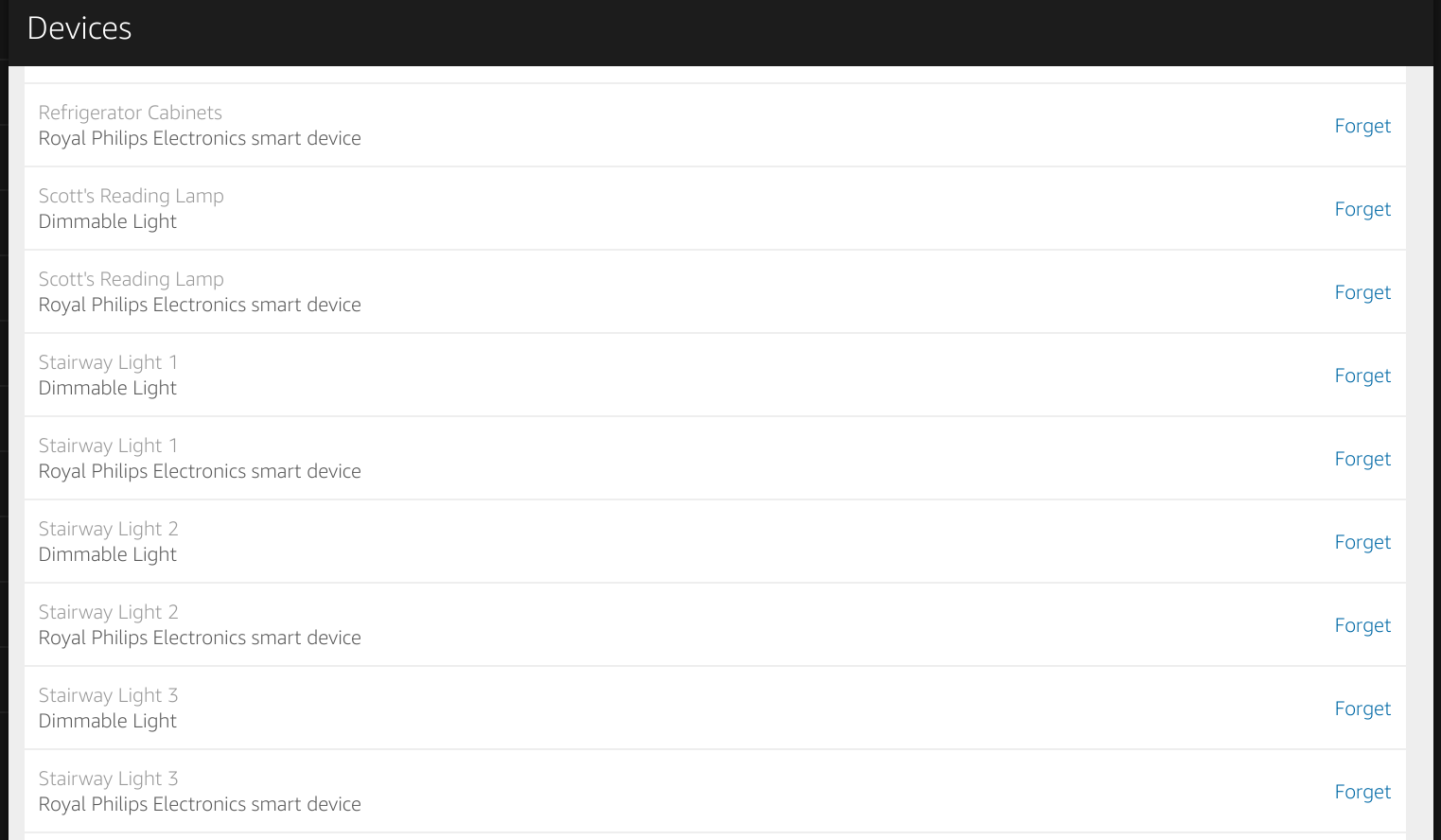

Update after Alexa app discovery after requesting that Alexa forget all devices
Through the Alexa page rather than the Android app (Alexa app does not offer a “forget all devices” aciton, but the web page does), I rediscovered all my emulated devices. Each device is discovered twice, first as “Dimmable Light” devices, then as “Royal Philips Electronics smart device” devices. I then tested at each of my Echo devices to verify that there was no “multiple devices with the same name” issue for Alexa.
Screen region capture following discovery:
Auto-updated Hue Emulation config (/var/lib/openhab2/config/org/openhab/hueemulation.config) after discovery:

Are the multiple devices discovered attributable to the string “Switchable” appearing in the settings for both the restrictToTagsSwitches and restrictToTagsWhiteLights options?
Same for me. But that’s a bug on Amazons side, we are exposing all devices only once. But it still works for me, no “multiple devices with the same name” issue. Unfortunately Amazon will never fix that bug, we have to live with double discovered items for now.
Thanks for the reply, David (@David_Graeff). Glad to know it’s not just my setup or a US vs. DE firmware issue. Everything is working well to this point, so I will continue to monitor and report any anomalies.
