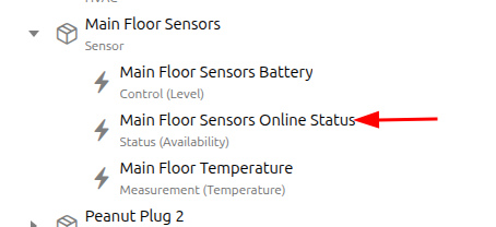

I use the semantic model to organize my Items. This is important because everything that follows depends on that.
Each equipment that I care about has a status Item as a member of the Group. It doesn’t really matter what the name is, but it is semantically tagged with “Status”. Here’s an example from the Settings → Model page:

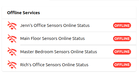

Monitoring the status from the UI
I’m a strong proponent of not showing stuff that doesn’t need to be shown. So I have a widget that only shows those services/equipment that are offline. If it’s online, there’s nothing to show.
Like the rule templates above, I’ve posted this to the marketplace as well: Service Status Standalone Widget
The widget assumes that any Item tagged with “Status” represents the online status of a service and it will only show it if that Item happens to be OFF.
All the rule templates and the widget can be installed through the Add-on Store. Read each for any additional requirements (e.g. the rule templates posted above require JS Scripting and openHAB-rules-tools to be installed (you can install OHRT from openhabian-config, using Install openHAB Rules Tools [5.0.0.0;5.9.9.9] or manually using npm).
