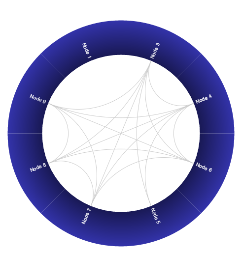

In Habmin my two fire alarms which the binding was never able to connect to are gray as expected. The controller is green and everything else is red.
The network shows everything connected to everything else EXCEPT for the controller which isn’t connected to anything.
Trying to reset or heal the devices does nothing.
