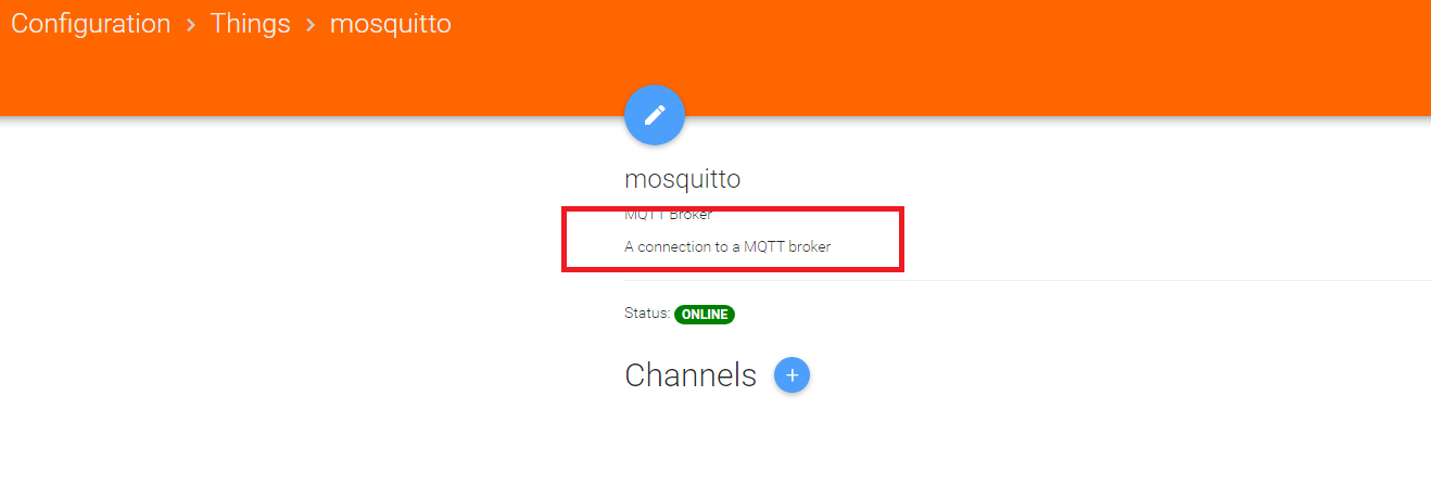

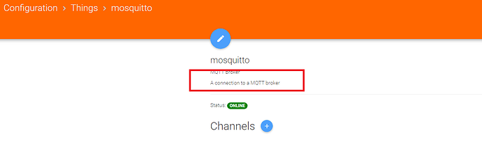

A small note, which I think is kinda confusing when running MQTT on openhab and may be causing misunderstandings.
The actualy MQTT Broker thing in PaperUI is quite misleading. Its not The Broker. Its a Bridge connection between openhab´s MQTT devices and the actual MQTT Broker. In my opinion this perticular thing should be named MQTT Brigde and not MQTT Broker.

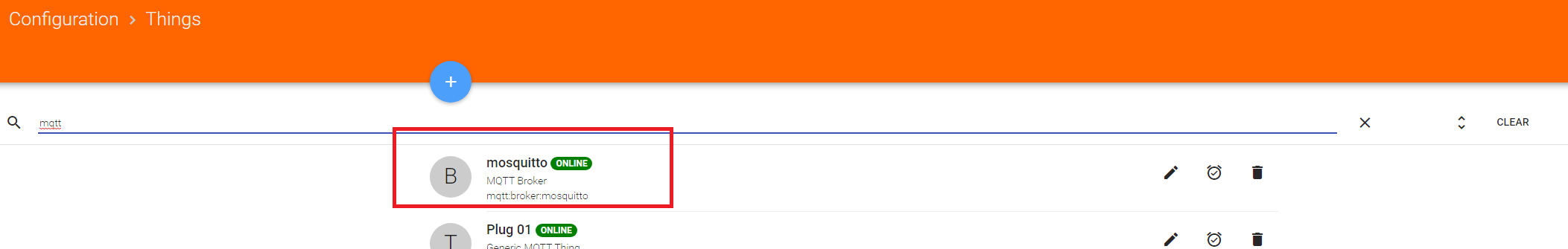

Here are some screenshots explaining.
First the Broker thing (which should be named Brigde in my opinion).
Entering this one, it actually says is “A connection to a MQTT Broker”

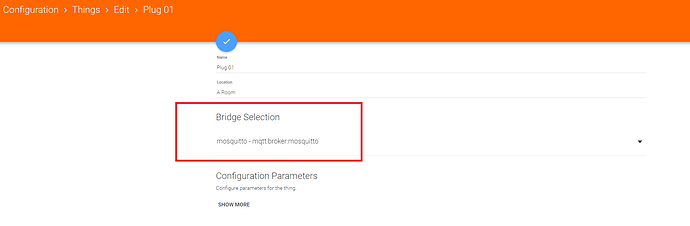

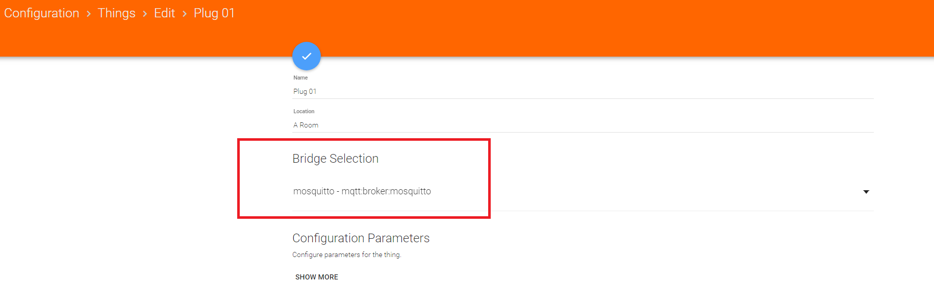

And last, the MQTT devices where you pick the Bridge, which is the MQTT Broker thing.
Notice it says Bridge Selection. And that actually points at the MQTT Broker thing.
Therefore is should be named, MQTT Brigde :wink:
