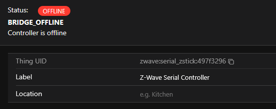

All ZWave things suddenly show ERROR:BRIDGE
I have an Openhabian installation running with a ZWave serial stick for a rather long time now. Recently all of my zwave automations quit working, which has happened randomly before but usually could be resolved by replugging the stick and restarting openhab.
Recently things quit working again, and now I am stuck with all of my zwave things showing “ERROR:BRIDGE”. Checking the thing for the stick, it shows the same as all of the rest of the things…

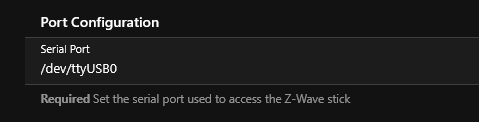

I have double checked that nothing changed with the serial port device name.

I enabled TRACE logging on the zwave binding to see if I could get any more detailed clues by disabling and re-enabling the serial stick, but not much revealing there. No warnings or errors or anything.
openhab> log:get org.openhab.binding.zwave
TRACE

Thing code for the stick, if it is of any interest…
UID: zwave:serial_zstick:497f3296
label: Z-Wave Serial Controller
thingTypeUID: zwave:serial_zstick
configuration:
  controller_softreset: false
  security_networkkey: RE DA CT ED
  security_inclusionmode: 0
  controller_suc: false
  controller_sisnode: 1
  controller_maxawakeperiod: 10
  controller_sync: false
  controller_master: true
  inclusion_mode: 2
  port: /dev/ttyUSB0
  controller_wakeupperiod: 3600
  controller_exclude: false
  heal_time: 4
  controller_inclusiontimeout: 30
  controller_hardreset: false
channels:
  - id: serial_sof
    channelTypeUID: zwave:serial_sof
    configuration: {}
  - id: serial_ack
    channelTypeUID: zwave:serial_ack
    configuration: {}
  - id: serial_nak
    channelTypeUID: zwave:serial_nak
    configuration: {}
  - id: serial_can
    channelTypeUID: zwave:serial_can
    configuration: {}
  - id: serial_oof
    channelTypeUID: zwave:serial_oof
    configuration: {}
Any hints on where else to look?

If I was trouble shooting this based on what you have stated i.e. not made any changes no upgrades or any other activities like that then I would start looking at a possible hardware issue.
Either your stick/controller is failing /failed or you have a failing sd card.
If it was me, I would try the cheapest easy way first and that is get a fresh sd card do a fresh load of openhabian on it and pop the stick in and see if it works.
Since all your devices and such are saved on the controller if the stick is fine it should come back up and find all your devices if that works pop the old card back in and do a back-up if you do not already have one then restore the back up onto the clean openhabian build.
This approach will quickly show where your issue is and what the next best step may be.
