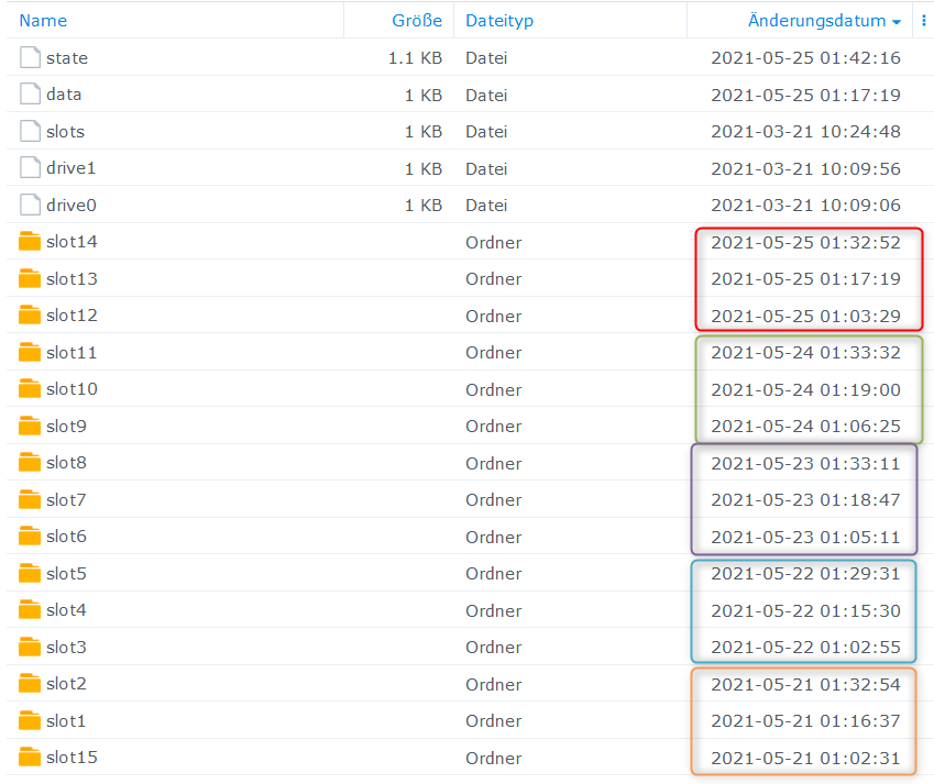

Normally, I would expect one slot per day, but it seems, there are multiple ones starting? is this normal behaviour, or did I break something?
I only started one manual amdump openhab-dir test monday afternone once (20210517145301), but it seems, i always get three backups for one. I started openHABian multiple time (could be three times?), to overwrite existing configurations, so could it be that?
