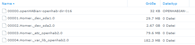

What’s puzzling me is the size of the (raw) backup partition files:
Shouldn’t it be the full size shown in fdisk -f?
Device Boot Start End Sectors Size Id Type
/dev/sda1 8192 92159 83968 41M c W95 FAT32 (LBA)
/dev/sda2 92160 62533291 62441132 29,8G 83 Linux
But it’s smaller:
EDIT:
Obviously the .0 files are compressed and not raw without compression like I am used to when using Win32DiskImager.

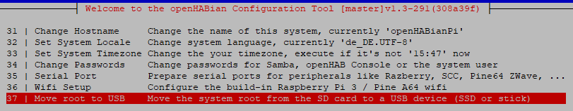

Hello @NCO, need a little advice for backup.
My openHAB is running on RPi3. I’m booting from sd-card,
but moved my system to an external usb ssd-drive by using openhabian:
