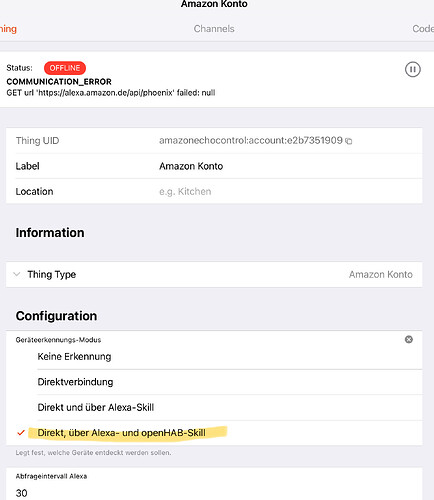

I have had to restart today two of my three OH installations on my PI’s.
On exaclty thoose two installation under 4.3.5, I’m gett this errors, that the amazon account seens not to be working. The other is stell “online”

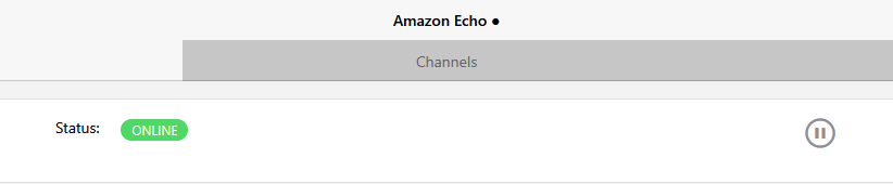

The Echo which is connected still works.
So it only the Account which is not “online” as an Item.

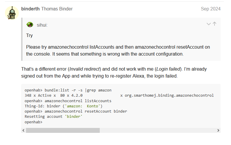

After resetting your account through the karaf console?
Then I am out of ideas …
I’m having the same issue. I tried resetting the Amazon account, and now I get the errors below when logging into the binding through the web interface. I’m in the United States if that makes any difference.

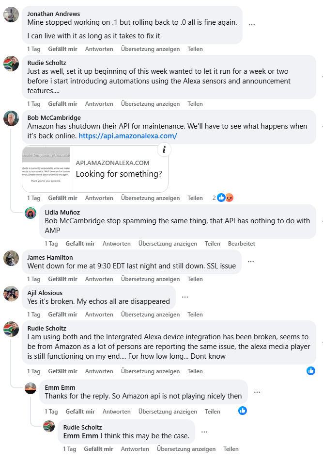

People on a HA Reddit are mentioning issues too. Hopefully it’s an Amazon problem.

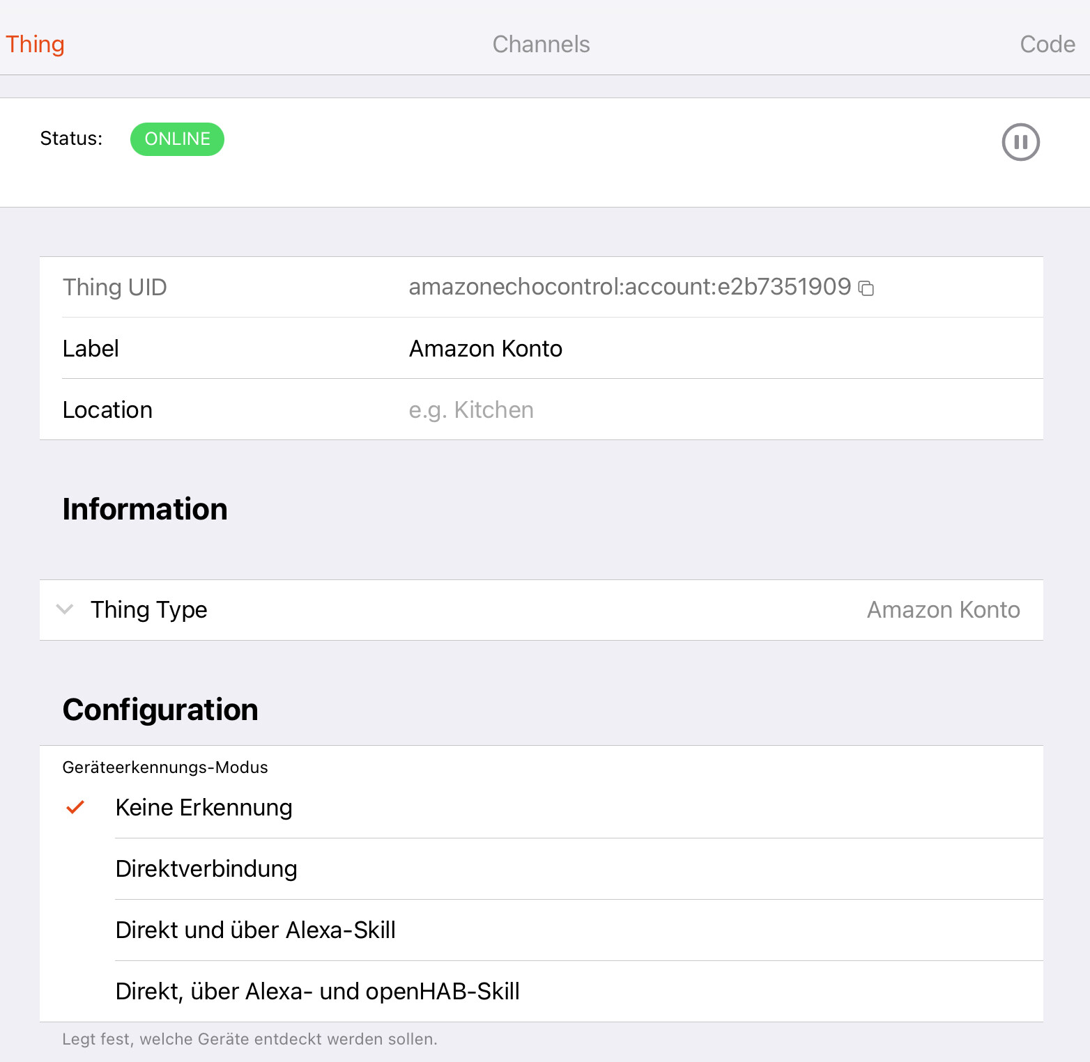

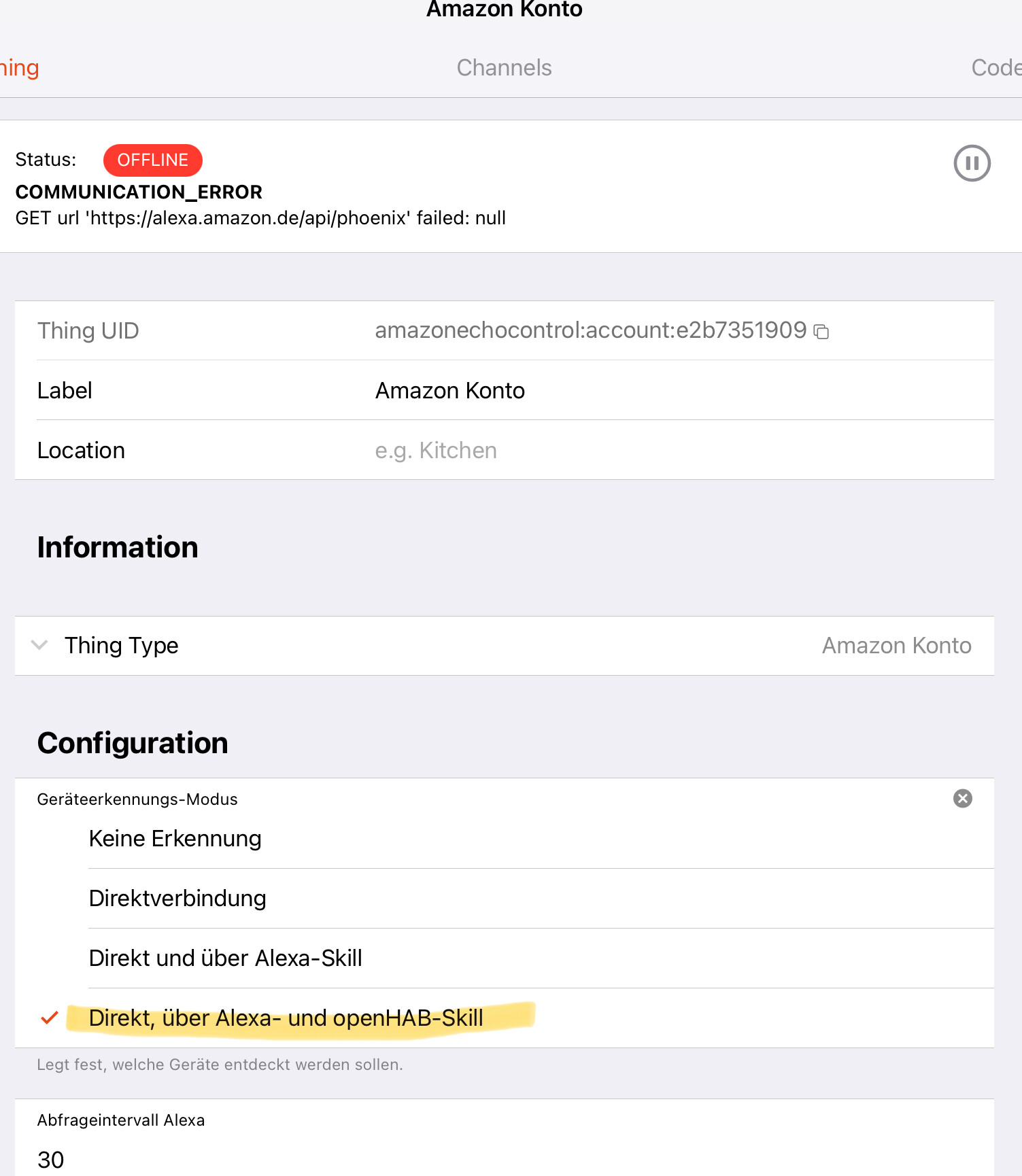

One more information.
I was able to bring them back to online, by changing the configuration type.
No, idea what the different values do here….
It works only, if there is no detection selected.
Thanks! Works for me in text coding with discoverSmartHome=0 again.
That works to bring the Amazon devices like Echo back online but I have several smarthome.devices and they remain offline, of course, if you deactivate that feature…

Other reports the same story:
Had the same issue. Changing the config helped for me aswell.
Same issue with https://alexa.amazon.es/api/phoenix guessing Amazon have changed something?

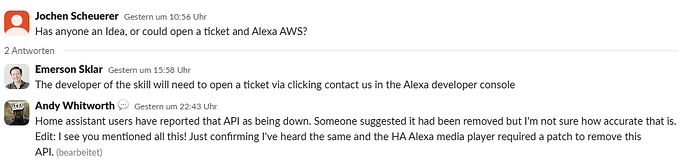

An update from the Slack Alexa Forum:
Ok. It looks like the HomeAssistant “Binding” was changed from the developers, in that way, that it works again now.
