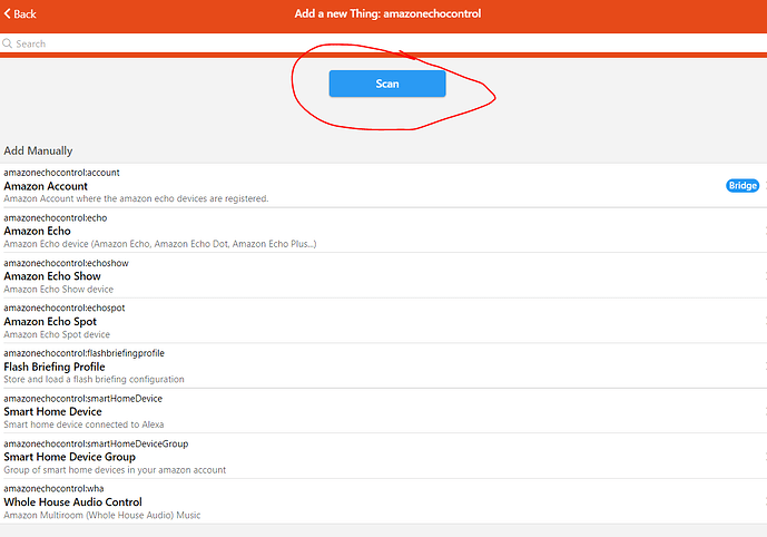

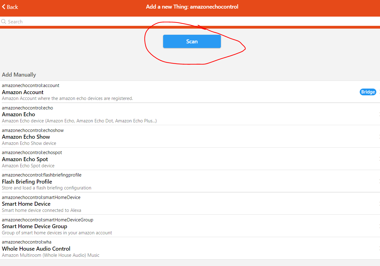

You have hit the SCAN button when trying to add a new Amazon smart device, it should discover all your smartDevices attached to the Echo account.

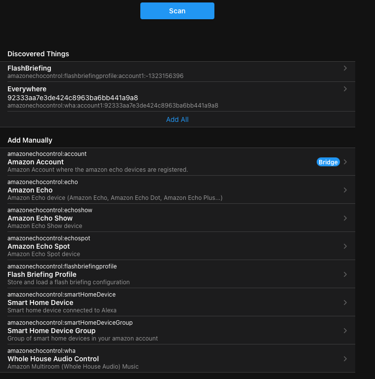

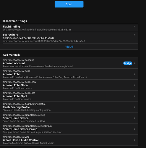

Thanks - sorry - I should have been more clear. I did scan, but don’t see any new things appear. I have a couple that I haven’t accepted…I’m unsure of where the Air Quality device should appear…

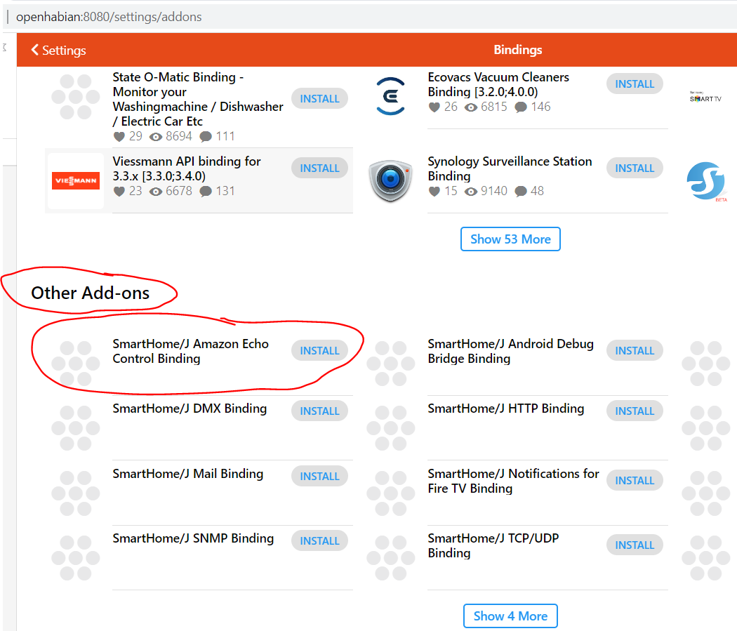

Please read the posting above yours, if you want more channels, you have to use the SmartHomeJ Echo binding located in the marketplace in the GUI.
Make sure you uninstall the official Echo binding first before installing this one below.

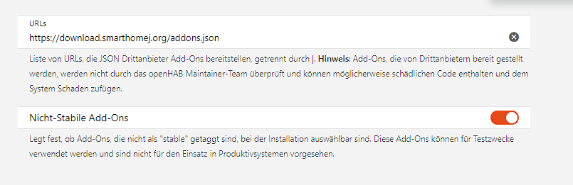

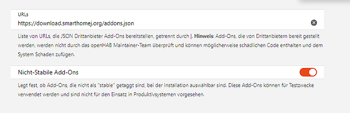

I have added the JSON to the 3rd party URLS
but yet I can not find it in the marketplace - is there something else I have to do ?
I had the same problem also, so I actually just grabbed it here. This ONLY works for OH 4.0, not 4.1.
