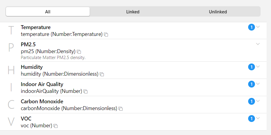

This version of the Amazon Echo binding has the Amazon Air Quality devices working for me over the last 25 days now.
Best, Jay
Found out about this and I wanted to share in order to keep up to date with the latest Amazon Echo binding.
If you’re on openHAB 3.2.0 or later, you can add “https://download.smarthomej.org/addons.json ” in the “JSON 3rd Party Addon Service” section in the settings page of the UI.
Once that is saved, go to the bindings page and you’ll see a new section with the 3rd Party Addons. You’re looking for the SmartHome/J variant of the Amazon Echo Control Binding.
*Be sure to uninstall the regular one before you install this one
Best, Jay

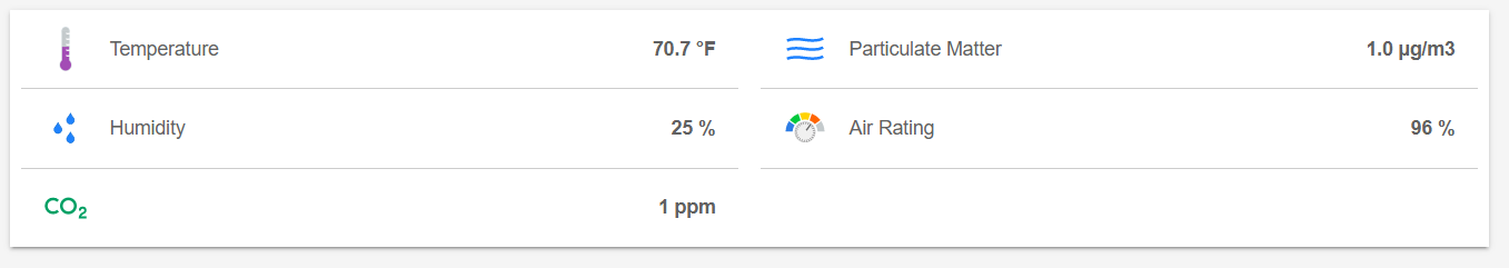

Did you manage to get it to pull any other data out of the Air Quality Monitor as I’m still only seeing Temperature in the Channels.
Yup, have 2 of them and the data is being actively pulled.
I would delete your device and rediscover it.
Best, Jay
