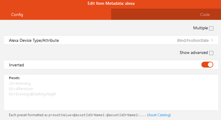

Sorry, I was confused today. My Amazon Alexa skill inverted 100% and 0%.
So in metadata of the item, you can “invert” the logic, and change the logic accordingly:
I have the same problem but when I change the “inverted” setting, nothing changes.
Is there anything else I have to do?
Ah, a rediscover of the Alexa devices helped!
