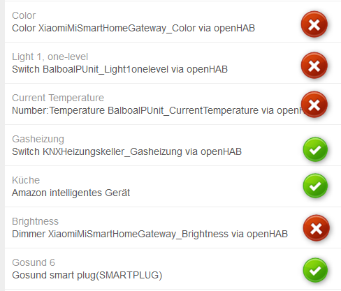

I switched to openHAB3 now, and while letting Alexa scan for my already “ready” items, which I provided metadata for, I also noticed, that Alexa did also find some items, which do not contain alexa-metadata at all. How do they go into Alexa?
The first three don’t have anything to do with Alexa, as it’s some Color-switch for my Xiaomi Gateway and the (beta) Balboa-Binding for my whirlpool.
From the green ones, I only added the “Gasheizung” switch via Metadata, the “Küche” is an echo and “Gosund 6” is a smart plug, which I control via Alexa, so that makes sense, those two are found.
But how will Alexa find those, which definetely don’t have metadata at all?
Is it, because the binding flags them as “lighting”?
The Alexa skill still supports v2 tags. Although, this will be deprecated at some point in the near future. So, your assessment is correct.
At the moment, if you want to prevent the skill from making such item configuration as Alexa-enabled, you would need to use this workaround.

  1. open the item, you don’t want in Alexa, but is Tagged (lighting, colortemperature, …)
  2. click “Add-Metadata” - “Alexa” to add something
  3. switch to “Code”
  4. fill out disable as value:
value: "disable"
config: {}
delete all devices in the Alexa App (or Web-App), and let Alexa search again. It shouldn’t be on the list anymore.
