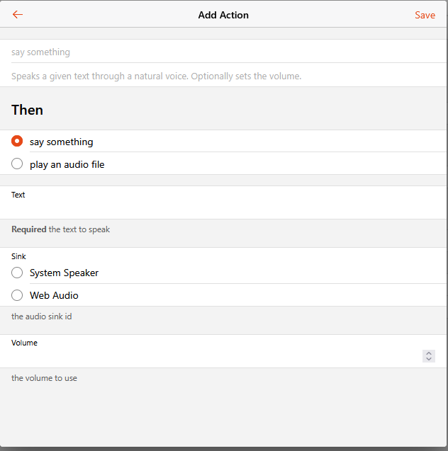

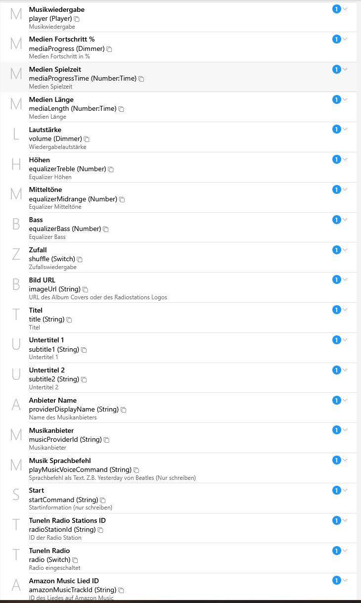

Thanks, but how to add the new item Echo which all his channels as a sink?
I can only use System Speaker and Web Audio.
The Echo is here with all his channels.
You can’t.

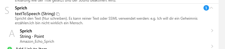

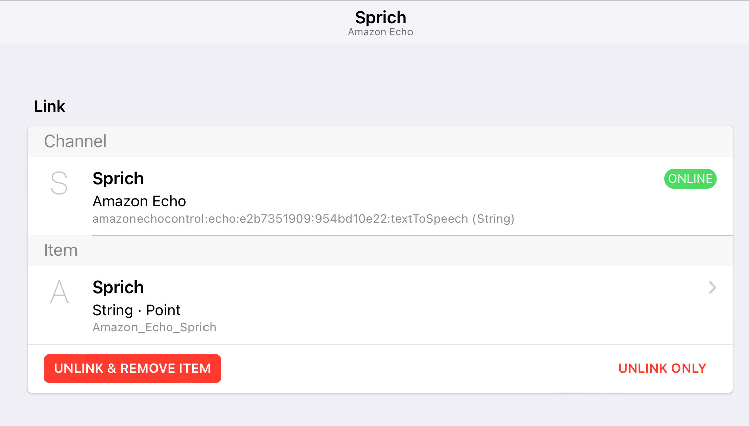

Just use an itemtype String and connect it to the textToSpeech Channel.

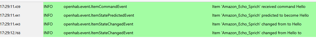

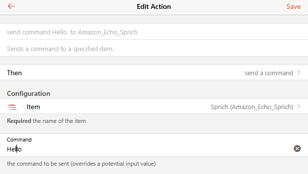

There was a channel created with a string.
I have created a rule which send the command “Hello” to this channel, but nothing happens.
In the logfile to command is received.
But no hello comes from the speaker…
What I’m doing wrong?

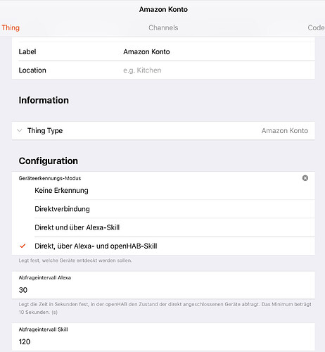

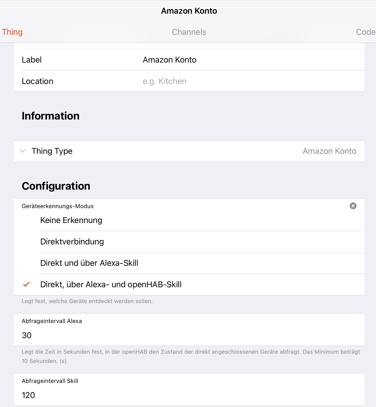

First I have had to adjust the Binding for the Amazon Konto.
Then I took the right tts channel called „Sprich“

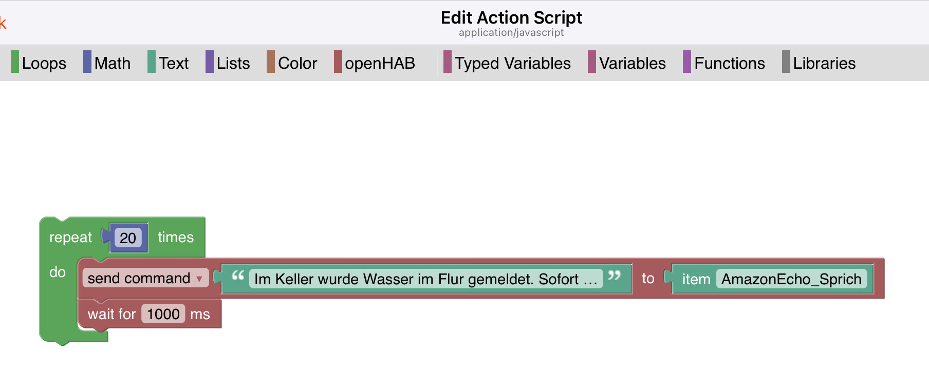

And final created the blockly rule, which the loop and the Text which need to be given out by the Echo.
Trigger is, when the Shelly flood becomes the signal that there is water.
The final look like now, that
  • I get a mail that the watersensor is active
  • I and the rest of the family gets a whatsapp that water is in the baseband
  • The Phlipps Hue lights start red blinking in the floor
  • And final now the Amazon Echo is giving me a 20 x Text Notifications.
