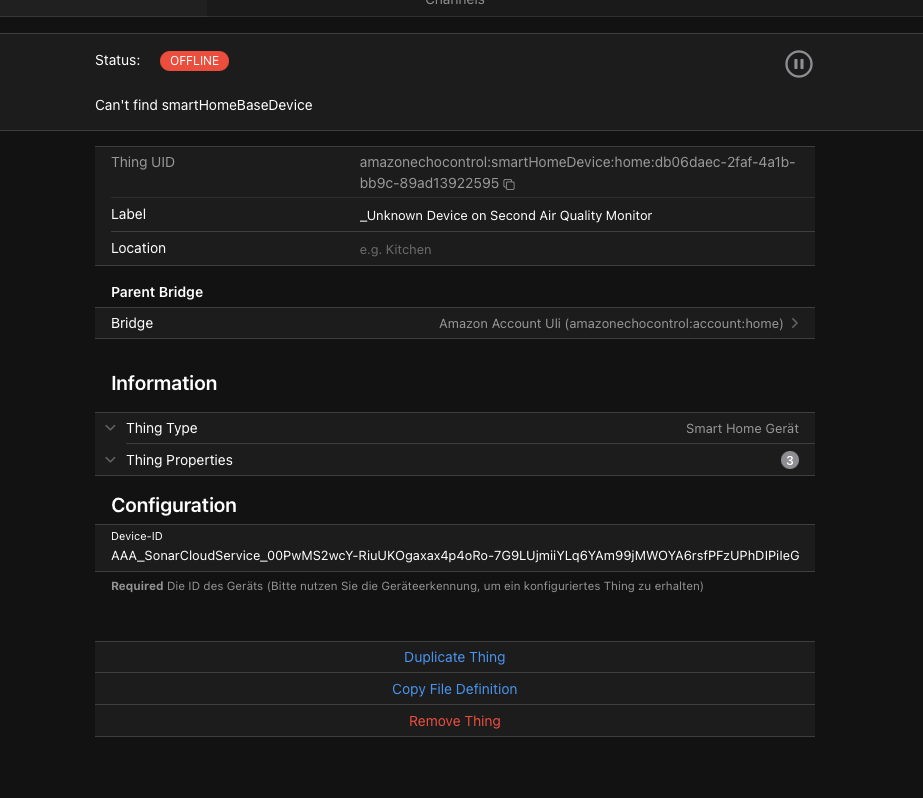

can you describe when “everything works again” exactly means? I am using the Air Quality Monitor from Amazon in Germany. The device is detected but I get “Can’t find smartHomeBaseDevice“ when I add the Thing. Does also Air Quality Monitors work for you?

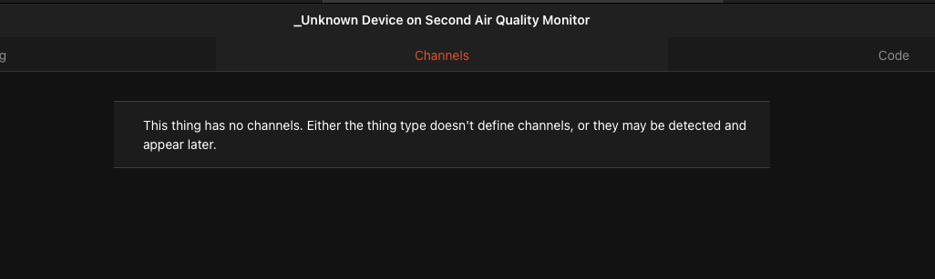

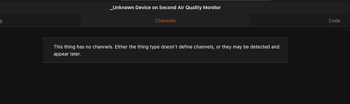

You find a screenshot attached. I saw now that the thing switches to online after a while, so that looks good. However, it has no channels and thus cannot be used (see second picture).
