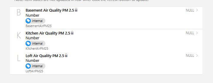

Hey @J-N-K
Amazon Air Quality integration has also stopped working that we worked together on a few years ago to integrate. It’s showing NULL now for everything.
Capture
I’m running org.smarthomej.binding.amazonechocontrol-4.3.2.jar
Best, Jay

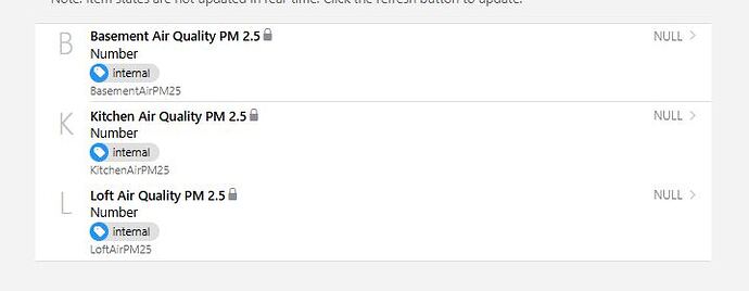

It looks like Amazon either addressed the API changes or reverted them back. The Air Quality of their own units started to work again this morning.
I’m still running the same binding as before.
I’m in the US.
Capture
Best, Jay
