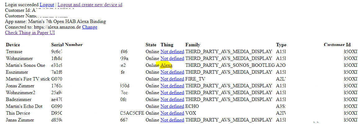

I noticed that even after trying to clean the system and doing a fresh installation of the binding the Amzon Echo Control I see some left overs of my former configuration. After doing a “fresh” installation of the binding I navigate to http://openhab:8080/amazonechocontrol/ to configure the account and there I see that there is still a Think associated with the problematic device. When I try to remove the Thing I get an error “409 - Conflict” within PaperUI

Checking the capabilities list of my sonos devices under http://openhab:8080/amazonechocontrol/ , i see that it says reminders. However, they always play on one device, no matter which one i use in my rules, output is always on the same.
Does changing the config of the things(serial numbers) require some flush or restart of openhab?
