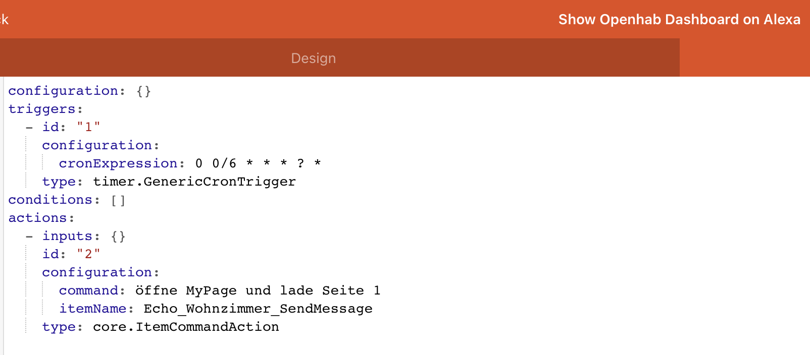

Since 28.09.2022 the “TextCommand” (execute a text command like a spoken text) of Amazon Echo Control Binding no longer work as expected - the behavior has changed. I use Openhabian 3.3.0 on a PI4. I’m not sure if this is a problem of the Echo Control Binding or a problem of the Alexa API. The VoiceCommand directly spoken to the echo device still works only the TextCommand (via API) no longer works. It seems that the problem arise in combination with Alexa skills where the first part of the TextCommand opens the skill and the second part of the TextCommand should be “transferred” to the skill. Does anybody experience the same problem … and possibly has found a solution?
example 1:
I use Echo Show 15 as Openhab dashboard and as display for the door camera. For that purpose I use the Alexa skill “MyPage”
To show the Openhab dashboard on the Echo Show, Openhab sends the TextCommand ”open My Page and load page 1” (Openhab repeat that every 6 Minutes because after several minutes of inactivity the echo show shows the default page again). When the doorbell rings, the item doorbell changes from OFF to ON and a Openhab rule sends the TextCommand ”open My Page and load page 2" to the Echo Show to show the Openhab page with the door camera view (stream) and “open door button” on the Echo Show. After two minutes Openhab sends the TextCommand ”open My Page and load page 1” to show the Openhab dashboard again. The TextCommand without "Alexa, " at the beginning.
In the above example the first part of the TextCommand “open MyPage” works but I have to write "MyPage instead of “My Page” (without space in-between). I the past it was vice versa. The second part of the TextCommand “and load page …” is wrongly understood by the Alexa API / Echo device as the Echo device responds “can’t find the video”. As said before the same command directly spoken to the echo device (VoiceCommand) still works. I have tested in English and German “öffne My Page und lade Seite …”.

Thank you @Wolfgang_S and @christoph_wempe for your quick reply. The LowerCase approach for TextCommand solved the problem or is at least a good workaround. Everything seems to work again with that fix.

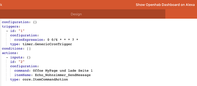

I use the following rule to overwrite the screen (with the Alexa skill MyPage):

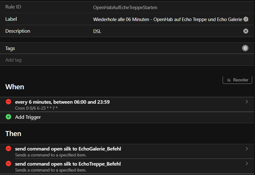

… and after that I update the screen every 6 minutes with the following commands, to avoid overwriting of Openhab with echo stuff every 6 … 10 minutes:
the command “open silk” does not update the screen as silk is already started so you dont see the refresh (but you see the change of item states).

I would like to know which command you exactly use to send the command “öffne MyPage auf Seite 1” to Alexa?
Can you show me your code?
Thanks and regards
Reto
you have to define “page 1” (German: “Seite 1”) and “page 2” (German: “Seite 2”) within the skill

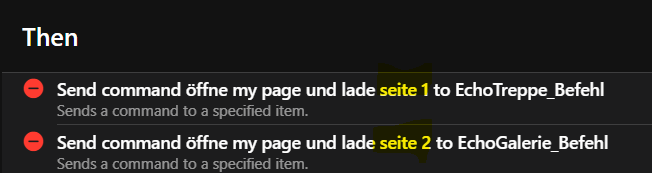

In the morning I load the page with
and refresh every 6 Minutes with
I hope this helps
… I have two Echo15, therefore 2 commands

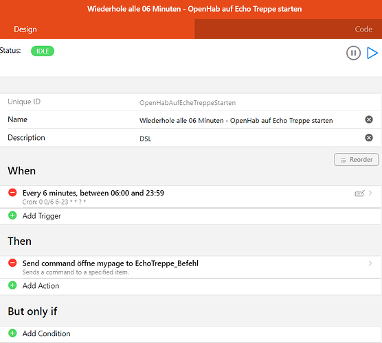

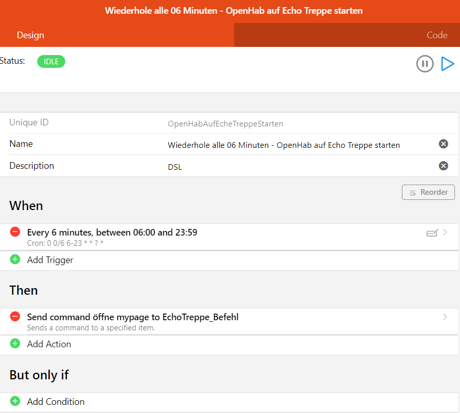

Here the code of my rule.
the rule on openhab instructs the echo device to start the openhab screen again on the Echo screen, to avoid the specific echo behavior to place other stuff on the Echo screen … if you don’t do that, there will no more openhab stuff be seen on the echo screen, at least after 6 - 10 minutes … you can try it
To refresh the sreen I use the command “open silk” which instructs the echo to open the last displayed page without any “optical refresh behavior” (“silent refresh”). If you use " öffne my page und lade seite 1" you will see “optical refresh behavior” which lasts 4 seconds every 6 minutes.
… what you see in the other topic items is that Echo is sensitive if you write with upper or lower case. That’s the reason why I wrote the echo command in lower case.
Yes, I send now all my commands to echoshow written in lower letters. Echoshow ignores all of my commands except the TTS this works.
I have two rules - the first I start in the morning and the second every 6 Minutes
First rule at 5:55 in the morning:
Second rule every 6 Minutes:
