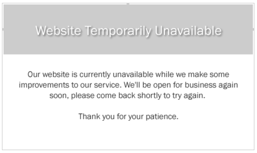

Am on OH 3.4.5 and see this error message in my account thing: GET url ‘You've received an Alexa Link failed: Not Found

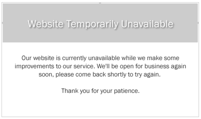

If i enter the address in a browser i get the following message:

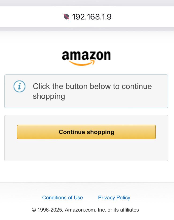

When now logging in via the servlet, I get this screen:

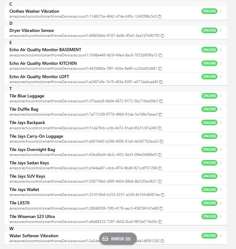

I find it so strange the smarthomedevices linked via Echo Control binding are online but the Echo’s aren’t nor is the Bridge/Account thing.
Capture
I saw someone else mention, mine weren’t when I checked a week ago and now all of them are with the bridge thing in pending config.
How is that even possible?
Best, Jay
